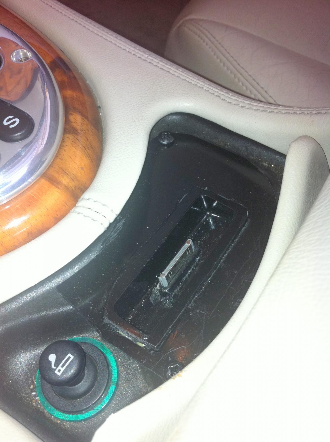

I used the cable and built a docking station into the ashtray. Works like a charm and it charges the phone as well. With the door to the ashtray you don't see a thing. Picture below:
Attachment 79665
How did you do this?
