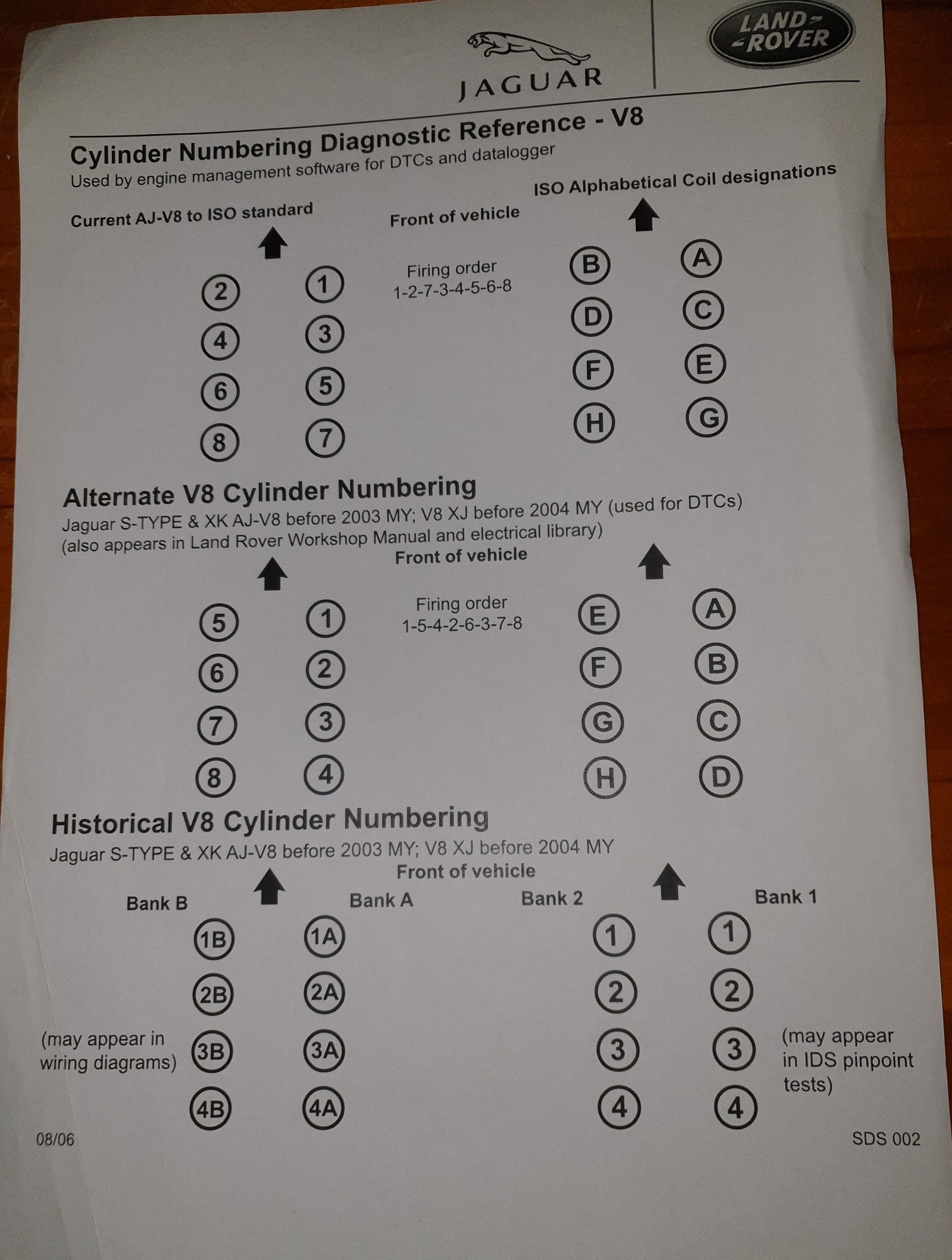

Might it be something to do with the model year of car? Jag changed the cylinder numbering system during the X100 production (around 2003) with bank 1 & 2 or A & B being changed to straight up number 1 to 8. Maybe that is communicated to torque pro differently.

l have no idea, sorry.
Cylinder designations sheet in pic.
