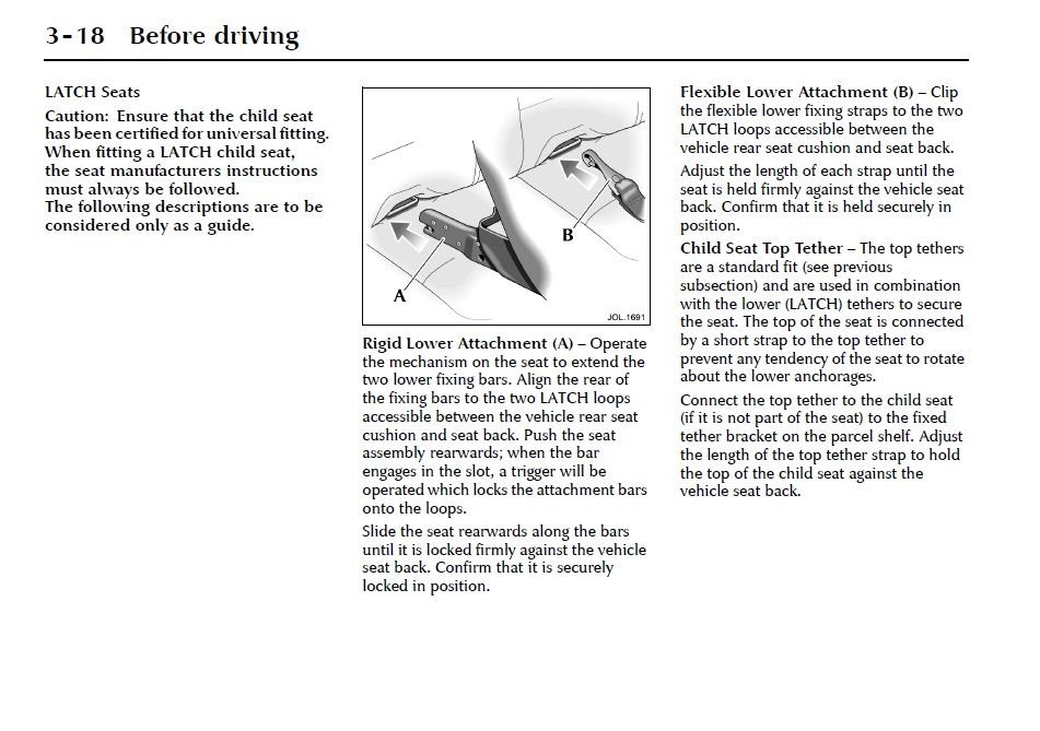

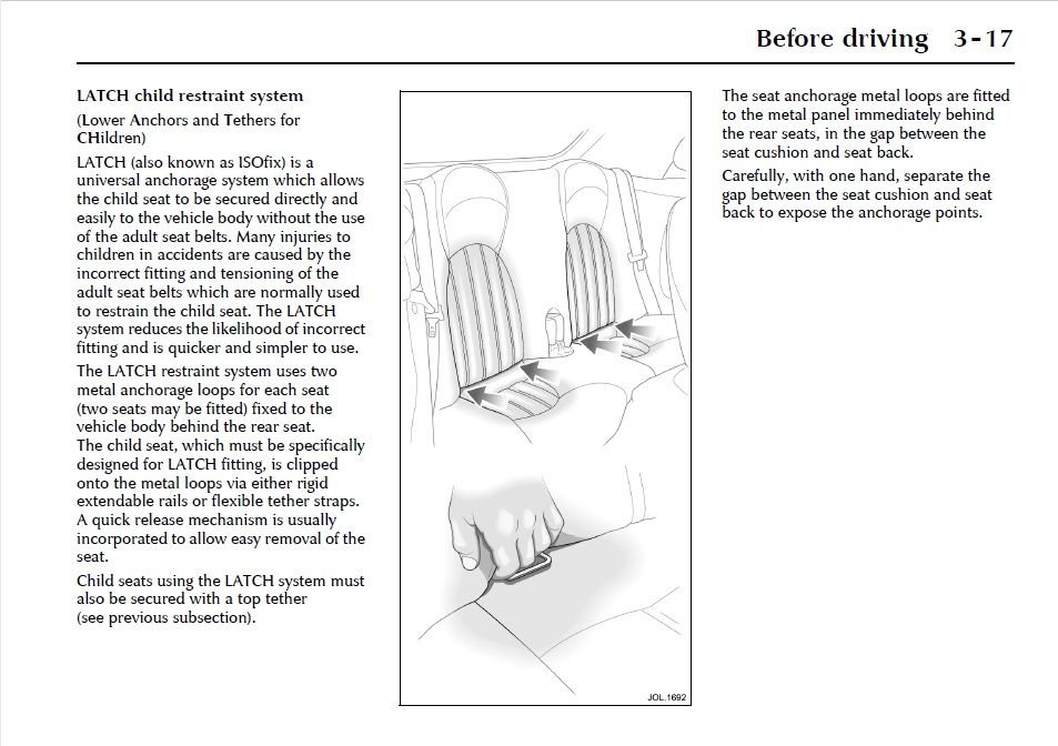

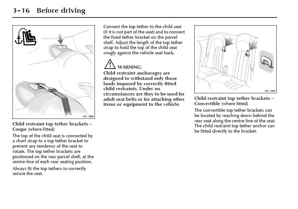

May 21, 2020 | 02:38 AM
The Child Restraint tether bracket instructions are in the USA version of the XK8/XKR Driver's Handbook:
The ebay listing does make clear these are ONLY the plastic covers. The anchors are not included.
