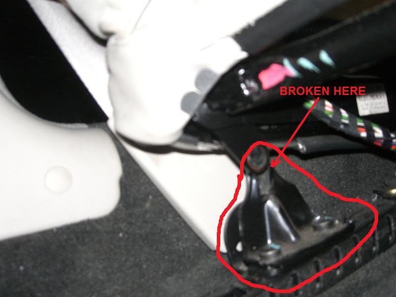

Allison, you are awesome! THank you for taking the time to talk to me. Here are the photos of what's broken on mine that I need:

I had the same problem. I could not figure out how to replace it for a new one. The top assembly is welded to the seat while the bottom one is screwed on. Do let me know how you get this fixed. Thanks
