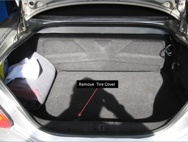

Drain the tank if you are going to pull the float, remove the tire cover in the trunk and the fabric that is against the tank below the rear window. In the middle of the tank is your fuel tank sending unit with a black and red wire attached to it.

The photos are for a 1999 but the only difference between accessing the fuel level indicator is that the model year 2000 and up has a metal cover at the tank that needs to be removed and you will see this when you remove the cover in photo #3. I hope this helps.
