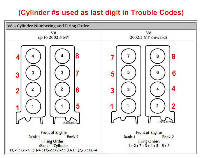

I have a 2000 Jaguar XKR. Code PO358 I believe it says number 8 cylinder. Which firing order ?? Does anyone know? Appreciate any help.

Hi Luis and welcome to the forum.
Cylinder 8 is, as you look forward, left hand bank closest to the bulkhead.
That code does indeed point to that coil or circuit to it.

For Additional Reference:
