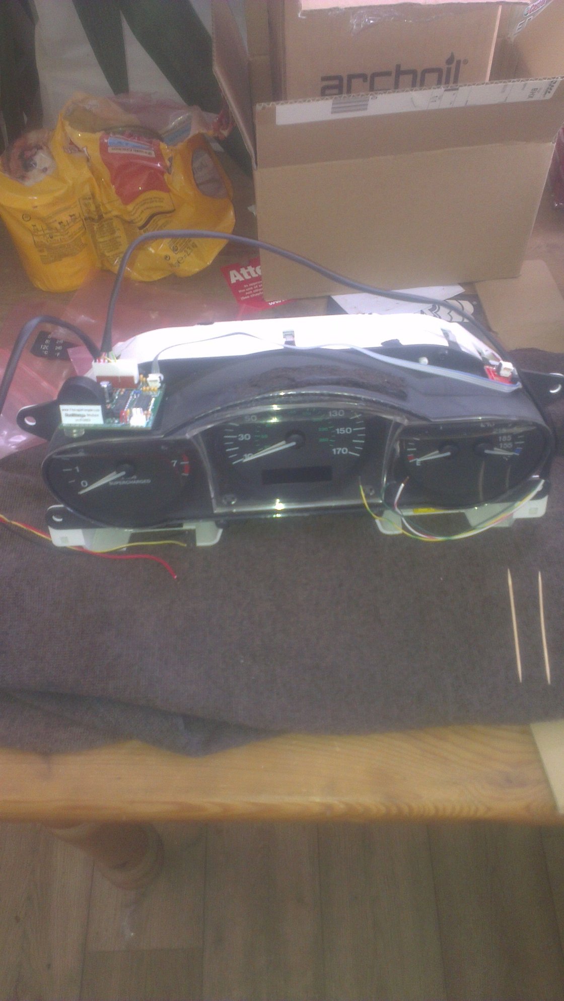

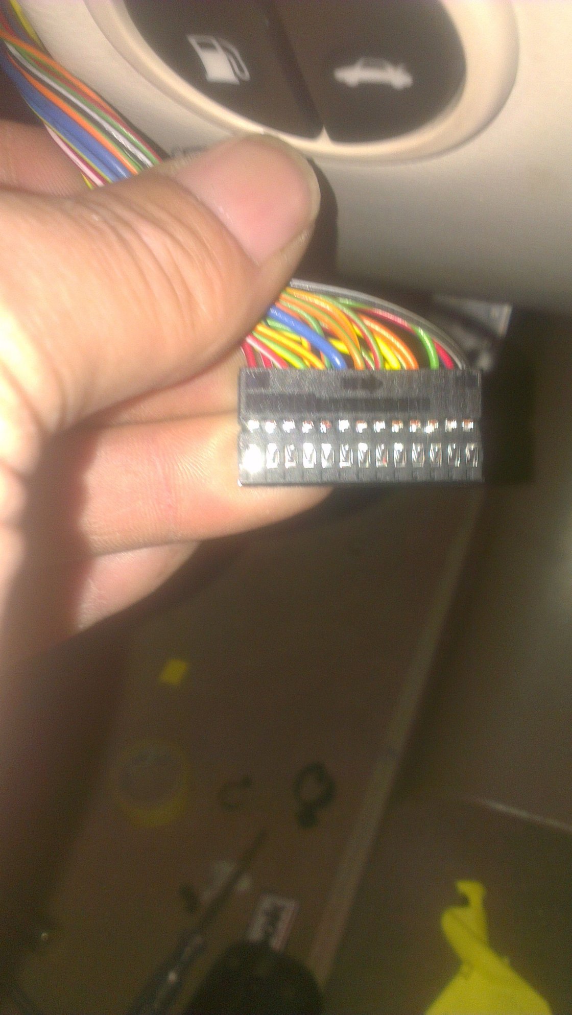

RIGHT SIDE YELLOW CONNECTOR OPEN TO IDENTIFY WIRE'S
ALL BACK TOGETHER WITH THE TEMP NUMBERS ADDED.....

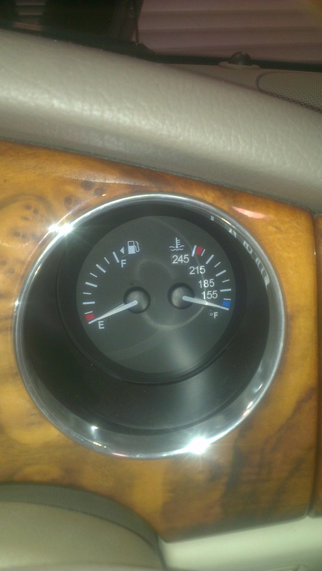

Well i received my temp real gauge from the JagWrangle,
Fast delivery from the USA to the UK
So today was the day for fitting,followed all tips and used the online installation guide and all went well...
My tip for the installation is;
When you do the right side yellow connector and have identified the wire's, USE SOME TAPE TO MARK THEM.
Then you can tap the connection's with out losing the wire's and having to recheck the pin number's..
All in it took 4hrs 25min for me to do, Well worth the time and money.
