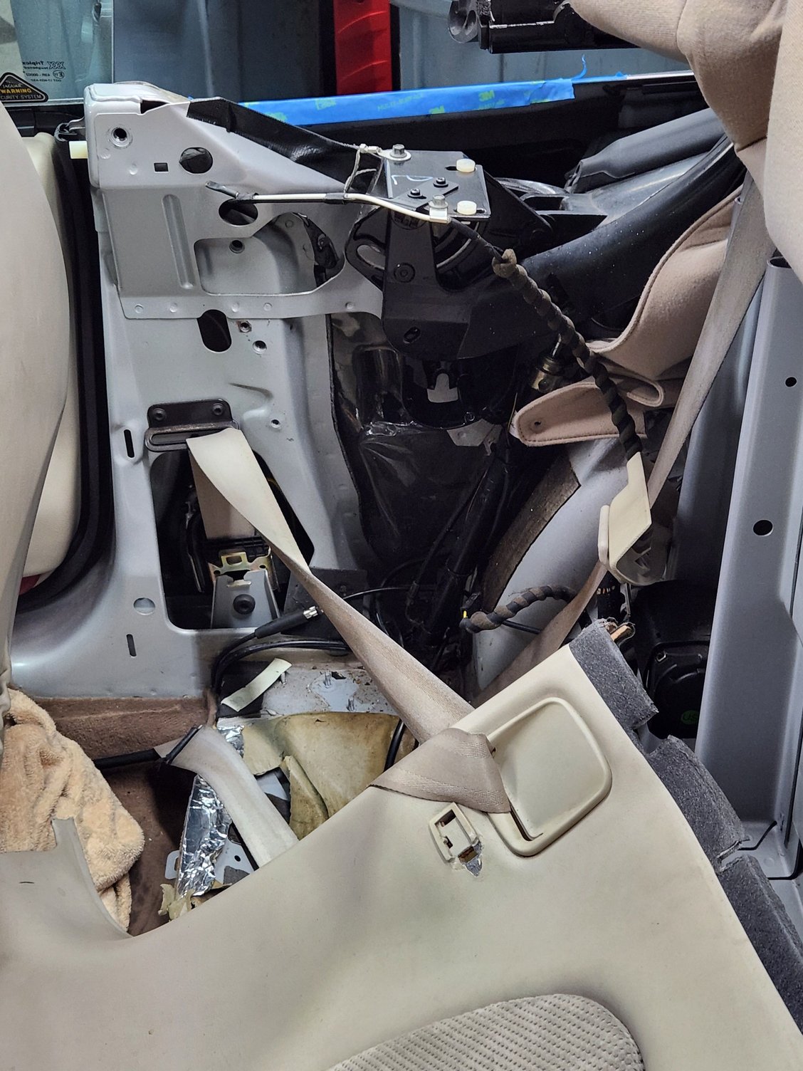

I am looking for location of key fob antenna, 1998 xk8 convertible.

If you were to take off the RH rear "cover," the thing right above the seat belt hanger, you'll see a sort of wire thing connected to the inner structure and running more or less parallel to the side of the car. This is the remote fob antenna.
In the pic, it's that white wire looking thing with the funny crimped black end.

Thanks, Ill check it out later this week....
