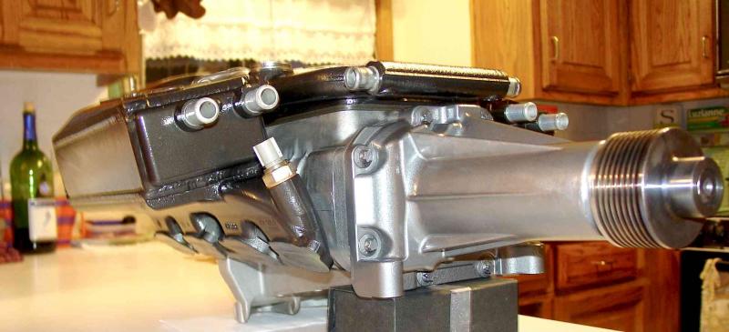

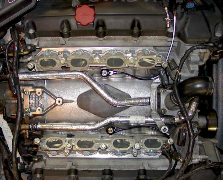

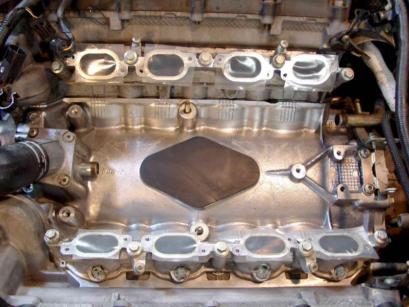

While I'm waiting for the injectors, rails and gaskets to arrive in the post, I have time to do a bit of detailing.
I decided that the top of my engine could look a whole lot better with a major cleaning and a change of finish. I cant take credit for the idea - I saw a similar color detail in a pic here on this forum several years ago. I remembered that as I worked what you see in the attachments. It's not powder-coat, Its "500 degree high temp enamel" color coat with a high-temp clear over the top.
I realize, with paint, have to be very careful not to scratch things up when I re-assemble the pieces!
My wife didn't get mad and was actually impressed with how the setup looked when she came home from shopping and found this setup on the kitchen counter!
Admission: It probably helped my case that, yesterday, I painted lady bug designs on her fingernails, huh? Hey! You got to give a little to take a little right ???
First pic is the before, the others I shot tonight.
Attached Thumbnails Leaking Fuel Rail pulse damper - OMG noo!-before-reference.jpg   Leaking Fuel Rail pulse damper - OMG noo!-b-dsc01258.jpg   Leaking Fuel Rail pulse damper - OMG noo!-c-dsc01247.jpg   Leaking Fuel Rail pulse damper - OMG noo!-d-dsc01253.jpg   Leaking Fuel Rail pulse damper - OMG noo!-e-dsc01255.jpg
Leaking Fuel Rail pulse damper - OMG noo!-f-dsc01252.jpg   Leaking Fuel Rail pulse damper - OMG noo!-g-dsc01254.jpg   Leaking Fuel Rail pulse damper - OMG noo!-h-dsc01256.jpg

Beautiful job, excellent detail work!!

Looks like an exhibition piece - superb detailing.

+1 on that - better than new.

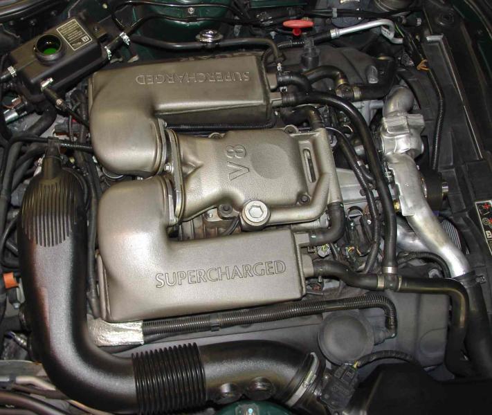

While you've got the s:c in your hands as it were - I was looking at my engine yesterday and had a thought.
The two bits with 'Supercharged' on them (technical term this) attach to a flange that bolts onto the s/c body.
If you could undo the flange and lift the two bits clear wouldn't that give access to the rails and injectors without removing the whole shebang?
Maybe it's a bit like the famous old Webley air pistol where a huge spring flies out and smacks you in the eye if any such thing is attempted.

Thanks for the nice comments guys!
I know I can make things look nice. But now the bigger challenge, get it all back together with no leaks and have it run right... The FIRST time.

Maxwdg - pic #4 - the flange that bolts to the main s/c body has one easy bolt on the top - is there an impossible one underneath then ?

Steve, to answer your question about the flange bolts in pic #4...
There are TWO bolts under the output manifold splitter of the supercharger. They are difficult to see and might be impossible to remove without first removing the throttle body and hoses on the back of the engine.
I just used the .pdf files that you and Graham bird-dogged for me and did most things in the exact order specified by JTIS. It really was not all that hard - even if tedious and complicated.
I guarantee there is NO-WAY to remove the charge air coolers with-out first taking the supercharger out. It's the bolts that are underneath the air coolers that fasten the coolers to the heads that can't be accessed.

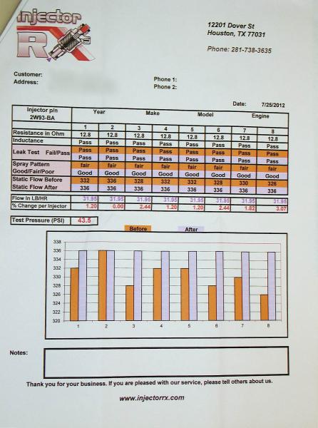

I got the injectors and fuel rail back from "InjectorRX" last Saturday.
To Recap: I found fuel leaking from appeared to be the pulsation damper on the left fuel rail. After the rails were removed from the engine, I could not reproduce the leak in my him shop....So I needed my rails pressure checked to ID the leak and fix the problem. I also chose this opportunity to have the injectors cleaned and verified as well. Additionally, I wanted to replace the rubber heater hoses and knock sensors that are located under the supercharger - they are all subjected to very high temperatures and prone to leak/malfunction.
Chris from Injector RX was very willing and interested to develop a way of pressure testing the rails. He had not been asked to do this before, but welcomed the challenge. I received a call about 4 days after I had sent my rails and injectors to his shop. He duplicated the leak - It WAS the pulsation damper. Chris found that the O-rings that seal the damper to the rail had deteriorated to the point that they would not hold a seal at the fuel system operating pressure. He said that the o-ring's poor condition were consistent with alcohol damage he had seen in other applications (marine systems are his specialty) in recent times. Straight high-test unleaded gasoline is a very rare find in and around the Kansas City area - so his assessment didn't surprise me.
Chris replaced the o-rings on each rail's pulse dampers and pressure tested the system under-water for two days. He pronounced them good-to-go and after cleaning the injectors sent them back to me. My cost for his work was approx. $210.00.
You can see the injector report attached as a file below.

You will see that in an attempt to shield the new heater hoses from the exorbitant heat they must endure under the supercharger, I have "aluminized" them with HVAC aluminum tape before putting them in place. I may have wasted my time with this little "shade-tree mechanic" trick - but I figured it couldn't hurt and it just may reflect a bit of the heat away from the rubber hoses... I really don't want to take this thing apart again for a coolant leak caused by a confound hose! You can also see the new knock sensors - also replaced as a preventative measure.
