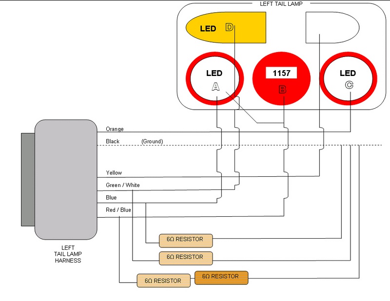

I've been successful putting LEDs in both brake and the adjoining marker. That thread.is located in the exterior modification subforun, search for the threads started by me to fing it. It oulines the unique resistor schematic to.eliminate the lamp failure messages. The CREE with built-in resistors work great in the turn signals though, w/o additional external resistors.

Here is the thread that I referenced earlier, it should help you get a better understanding of the possibility and obstacles involved.
Also, here is the schematic that I was referring to. If a CREE is used in the turn signal (indicator), then the resistor on that wire is not required.
