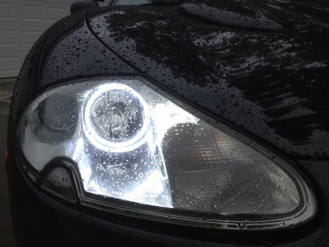

Are they similar to these? When we tried to do the same thing, they started flickering about a month later.
I'm modifying my fog lights to have small Amber Led turn bulbs in them. They will still function as fogs but I never use them really.

Yes they are very similar to those on your Jag. I got mine from ebay about £3.50 each and easy to fit. I havent had any problems with flickering at all and mine come on after about a 10 second delay after start up.

Mine only flickered when they were programed witht the turn signals. Now they are steady burn and fine. I think mine were about the same price!
