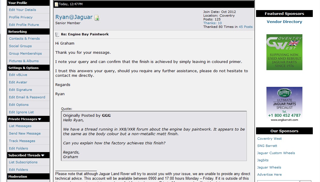

Old Jan 20, 2015 | 07:15 AM
Frank,
The solution is simpler than we were all thinking. Here's the reply from Jaguar Land Rover Ltd in Coventry:
It isn't a special paint or an additional process, just leaving the guide coat without applying the clear gloss.
