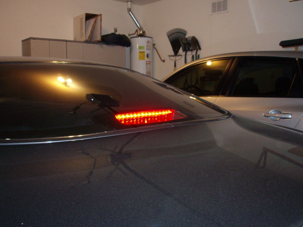

Originally Posted by ccfulton
Since mine didn't work and I wouldn't be out anything if I destroyed it, I attempted to repair the LED bar by removing the board from the assembly, de-soldering all of the components and replacing them with new.
The part I used was: C503B-RAS-CY0B0AA1
624nm, 15deg viewing angle, 14680mcd brightness, also made by Cree
C503B-RAS-CY0B0AA1 Cree Inc | C503B-RAS-CY0B0AA1-ND | DigiKey
Not the greatest picture but it's way brighter than the non functional one was and the 15deg viewing angle isn't a problem behind the diffuser.

On the convertibles the leds are actually white (with red lens), so have ordered a white cree variant based on similar specs you mentioned (assuming they are indeed similar...) with some more luminens (couldn't resist), but they are so cheap I can afford a miss buy.
Can you let me know what you had to do with the resistor? Was it needed to create a higher resistance to fool the body processor the lights are on?
Old Feb 27, 2013 | 12:19 PM
  #46
ccfulton's Avatar
Posts: 2,953
Likes: 1,120
From: Phoenix, AZ USA
The LEDs are in a clear case but emit red light, the part I listed is the same (624nm), just brighter. You won't want to use actual white emitting LEDs because you will end up with a mostly white (probably a little pink) brake light.
The resistors are necessary to make sure the current through the LEDs is correct so that they don't burn up. The body processor doesn't pay any attention to the 3rd light at all.
I can't find the circuit diagram I drew at the time, but I recall the circuit layout was a bit odd looking. You can follow the traces in the board to figure it out and then calculate the parallel and series resistance with the LEDs to determine the resistor size you need.

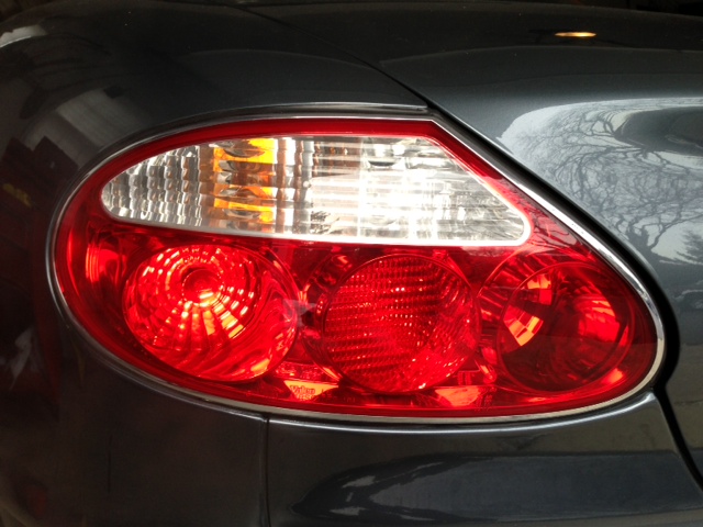

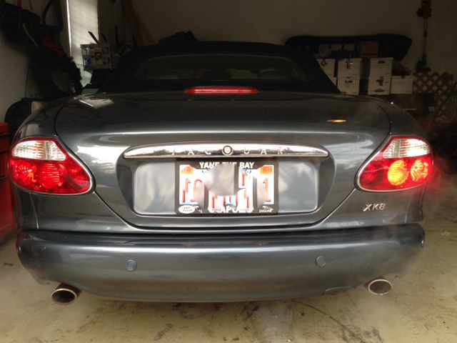

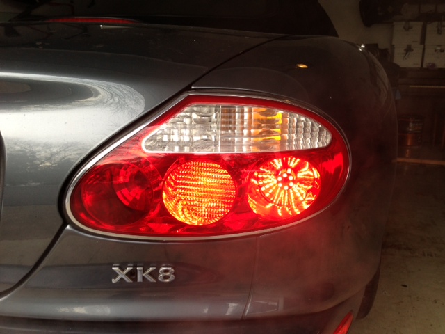

I replaced the 2 dual filament bulbs in my (U.S.) passenger side tail light assembly to compare new bulbs with old. These are the outer most bulbs at the bottom of the assembly.
Bulbs from "Super Bright": see post #15 in this thread from Frog. The pic's look a little orangy but they are bright red in reality. You can see the difference in brightness in the first pic where you can see the both tail lights in one pic. All pics are just with the headlights on- no brakes applied.
As far as aesthetics the only "LED" looking difference is in the dead center of the bulb (see middle pic). There is a small circle of 6 obvious LED's with lights on. Unless you notice what bulbs look like now on cars with the lights off you won't notice anything here with the lights off.
For you traditionalists, I will leave it to you but I think they still look classic but way brighter and taking less toll on the battery. Jac
PS- Here is how I replaced the bulbs: In the trunk I unscrewed the the two caps that have the tangs on them for cargo net. Pulled cover off. Took 3, 10mm nuts off. Slid the whole assy forward a bit. Pushed down on wire-like clip on top of electrical connector and pulled connector off. Removed assembly: I wanted to clean it all up anyway. Unscrewed one black threaded on cap that allows the board with the bulbs to separate from the exterior tail light cover. Press in and turn bulbs anti-clockwise and lift out. Had no troubles, took 15 minutes with cleaning to take it apart and get it together.
Attached Thumbnails LED stop bulbs-jagtailboth.jpg   LED stop bulbs-jagtailnew.jpg   LED stop bulbs-jagtailold.jpg

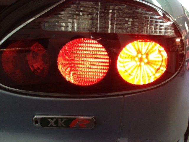

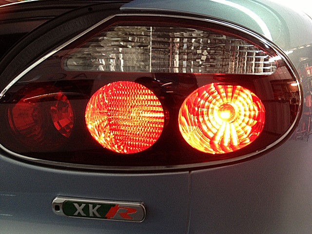

Well, I installed my LED bulbs today. They're ok, but I am not 100% convinced.
The two intensities work fine, but the colour is very slightly orange compared to the old bulbs. Also, you can see the little LED lights through the lens which looks a bit odd. Finally - and most annoying - is the 'CHECK REAR LIGHTS' warning message I have on the dash every time I brake and/or switch the lights on.
The bulbs say CAN Bus on the box, so I'm at a loss. Has anyone else had issues?
Old bulb (left) compared to LED bulb (right)
