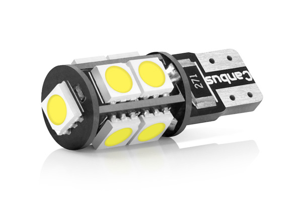

Just to fulfill the above request of my fellow Midwesterner I bought the resistors and some other bulbs.
Here is what worked for my 01 XK8:
A) WLED-x5-CBT (the "x" is a variable for a color. Amber=A, White=W, Red=R). I put two whites above my license plate, two reds for markers in back and two amber for markers in front. No problems, they are all plenty bright, no resistor or any mod's needed. The plate lights are a really nice color with my gray paint as opposed to the normal bulbs which are dingy and old looking (see left side of pic for regular bulb and right side for new).
B) 1156-W26-CBT. White back up light. WOW! They light up like a headlight. Really helps with backing visibility...significantly. No resistor needed.
Here is what did NOT work:
C) Brake light (1157-R26-CBT). With or without part RL-650 (6 ohm, 50W resistor) I kept getting a "check rear light" message shortly after I turned lights on (I didnt have to step on the brake for the message to come on). When the external resistor was connected, the resistor was heating up as it should but the light was slightly flickering.
D) Running light (bottom, center red light). No go, same thing as C. I kept original bulbs everywhere else when I tested these so I wouldn't be changing two variables at once.
So I called today and returned the 4 Red 1157 bulbs and the 4 resistors I bought. They have a 30 day return policy. They should refund my money when they get the bulbs. Assume they did that unless I post otherwise. www.superbrightleds.com
I will keep searching for plug and play!!

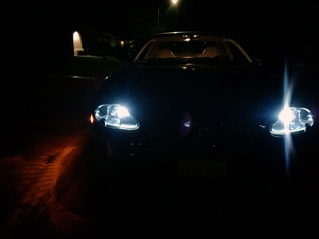

Really appreciate the sharing about your experience with LED's. I've currently replaced my parking and turn signal bulbs in both headlights, and am waiting for the order of tail light replacements to arrive. Below is the picture of parking/auxiliary LEDs. Big difference in brightness hence functionality in my opinion.
I purchased all my LEDs from CARID.COM in case you are interested. Really disappointed over the reports of error messages generated by tail light control unit...at least I know that I can return ones on order .
