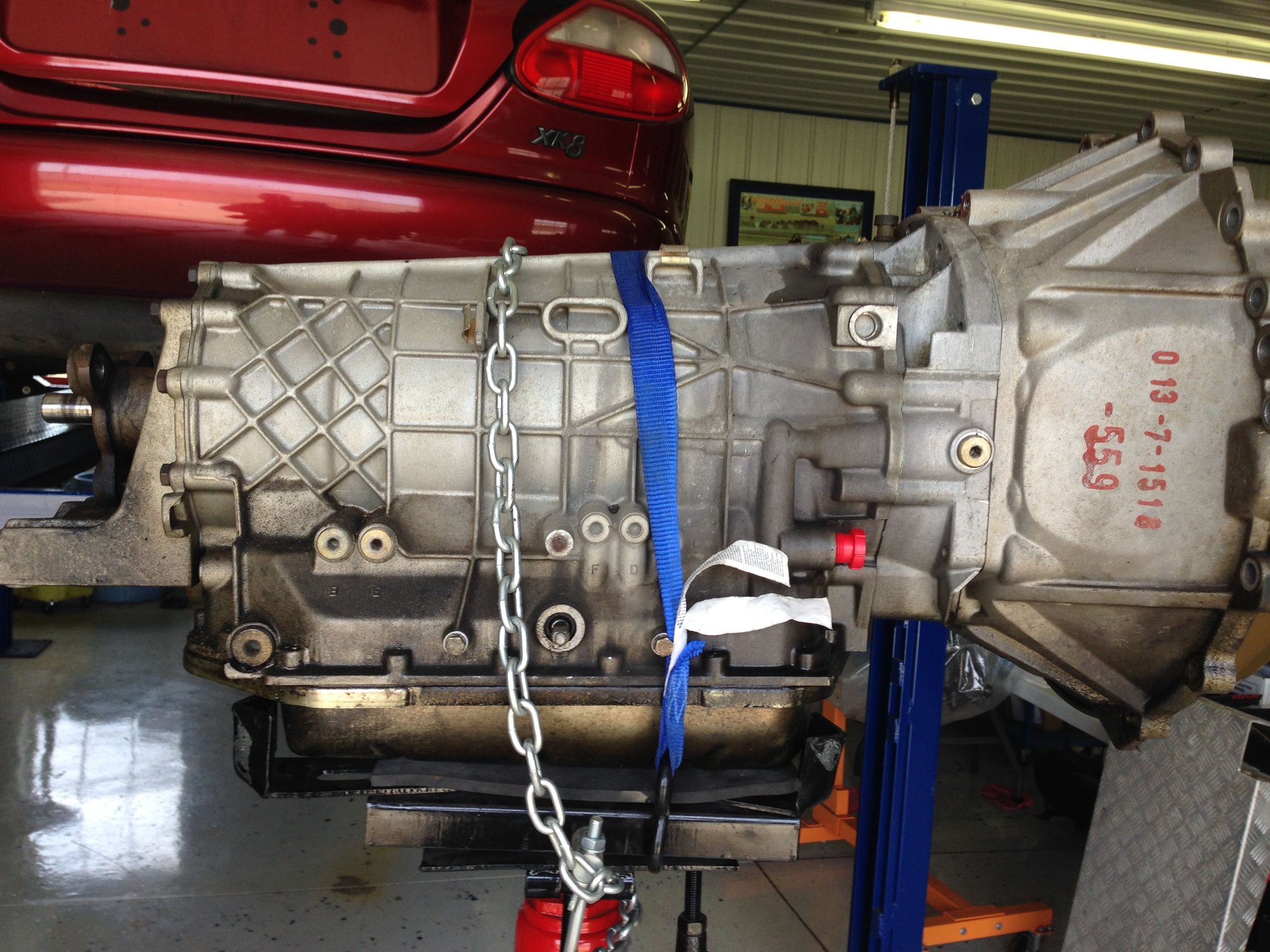

First job was to replace the rear main seal.
Nothing like diving in head first into a transmission pull!

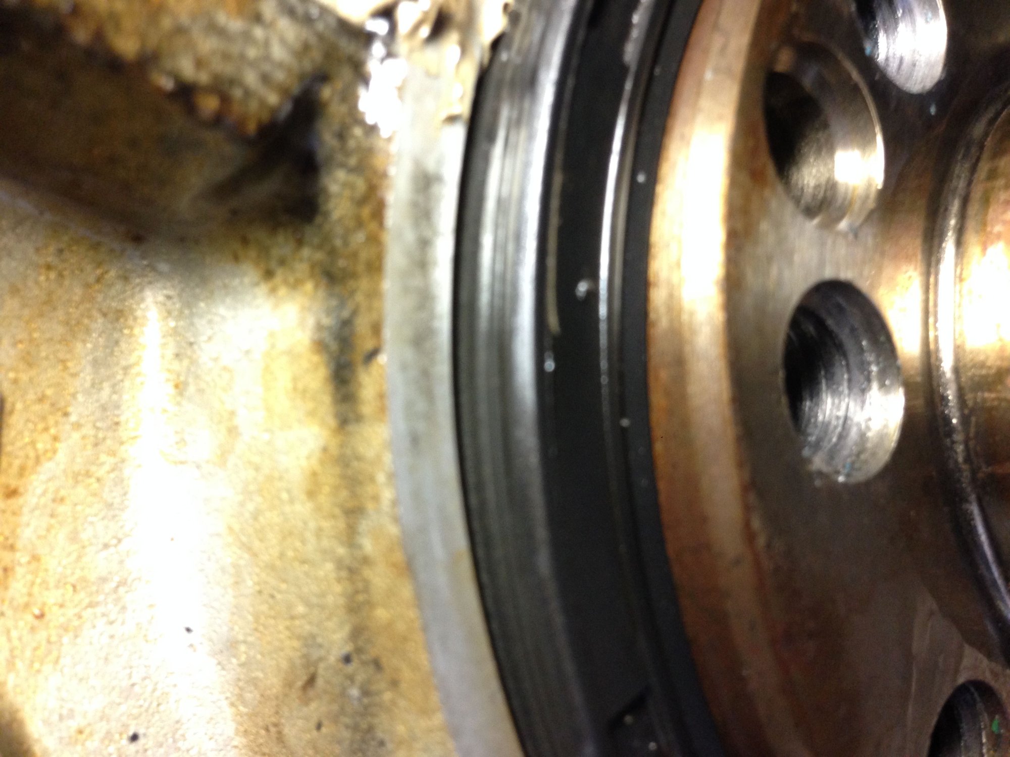

The rear seal was loose! No wonder I lost quart a mile on the test drive!
Old loose seal!
New seal installed, no more leaks.

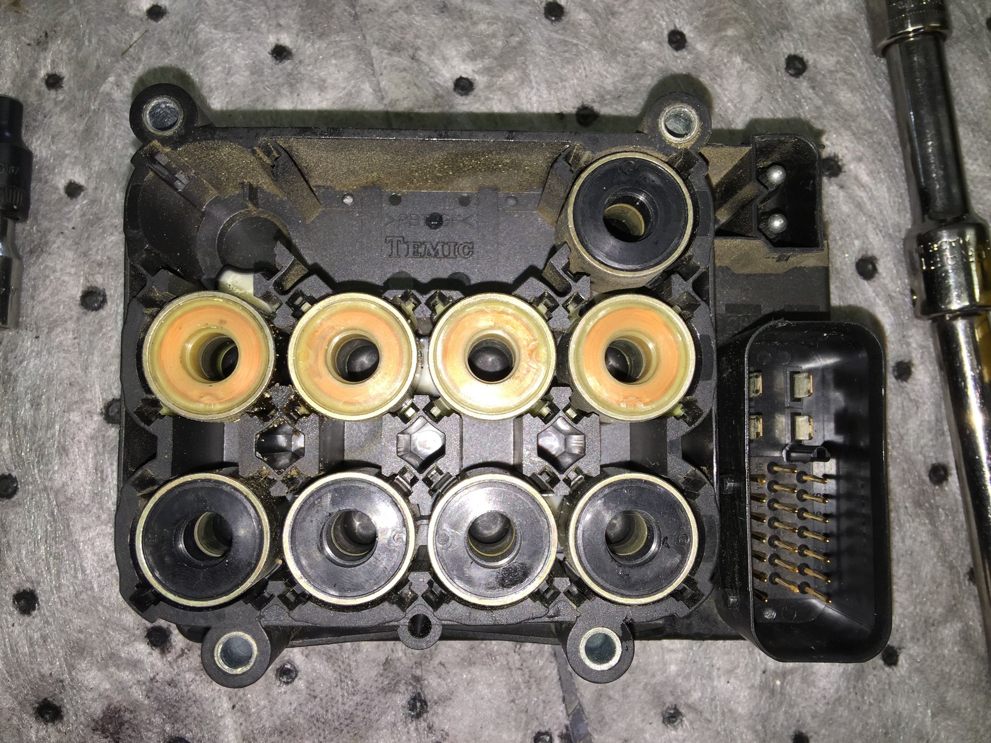

Module first. Solder joint broken on one of the usual two suspects. Sure was a bear to open!
Bad solder joints in the regular place!
Both heated and re-soldered for good measure. Hopefully itll last a few more years!
Looks like the unit had been repaired twice previously by BBA Remanufacturing.

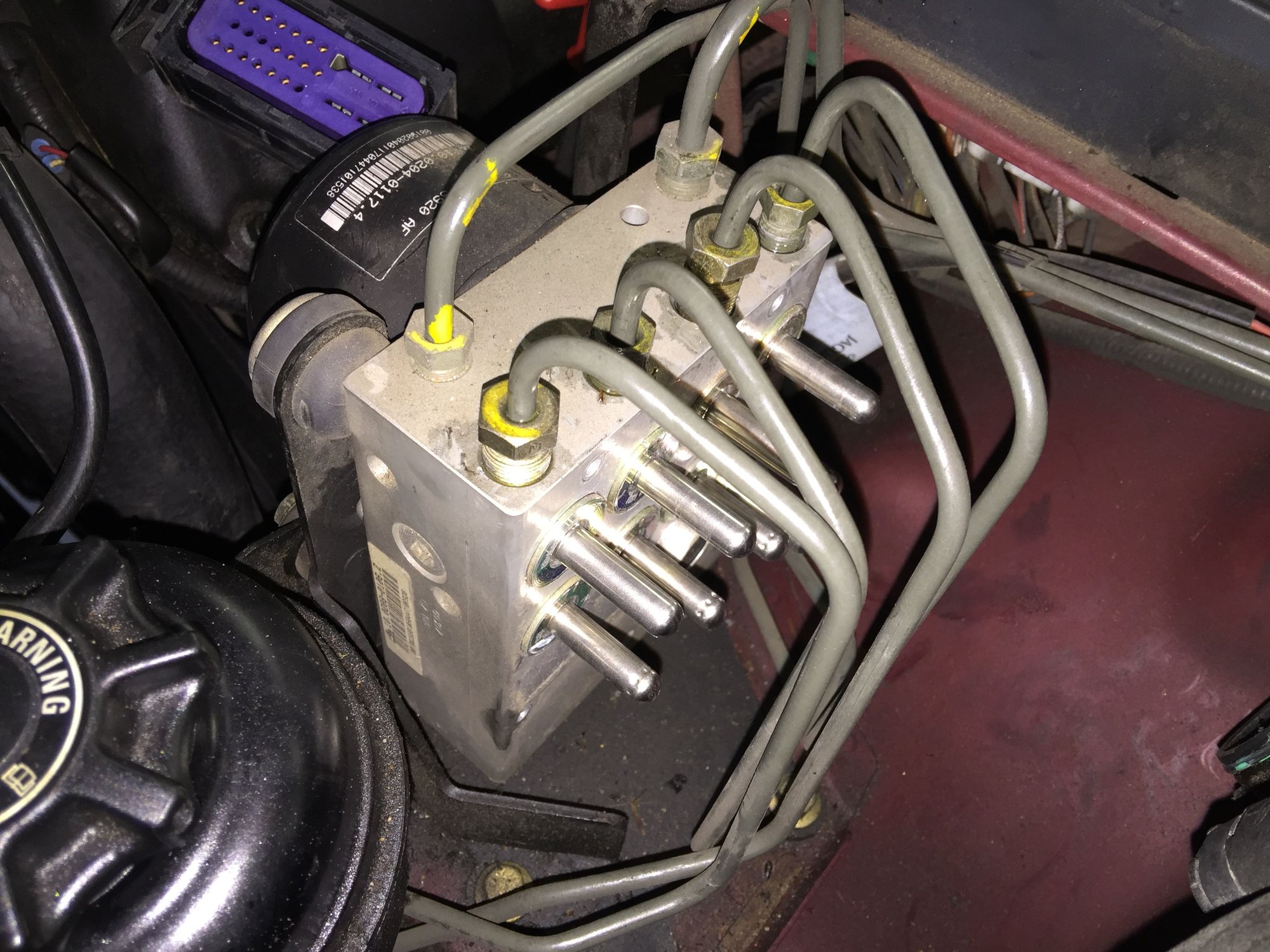

Unit re-attached and brakes bled.

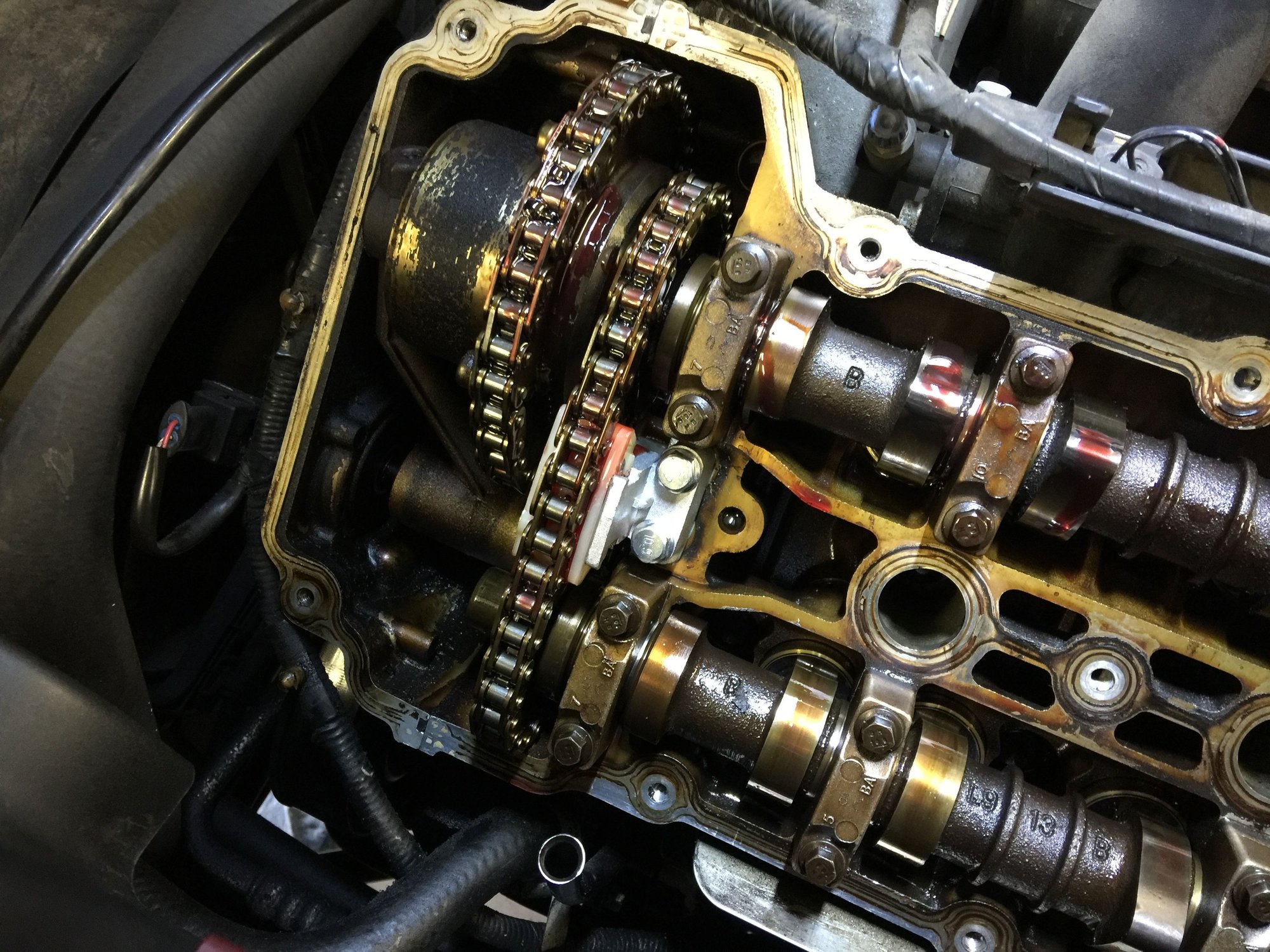

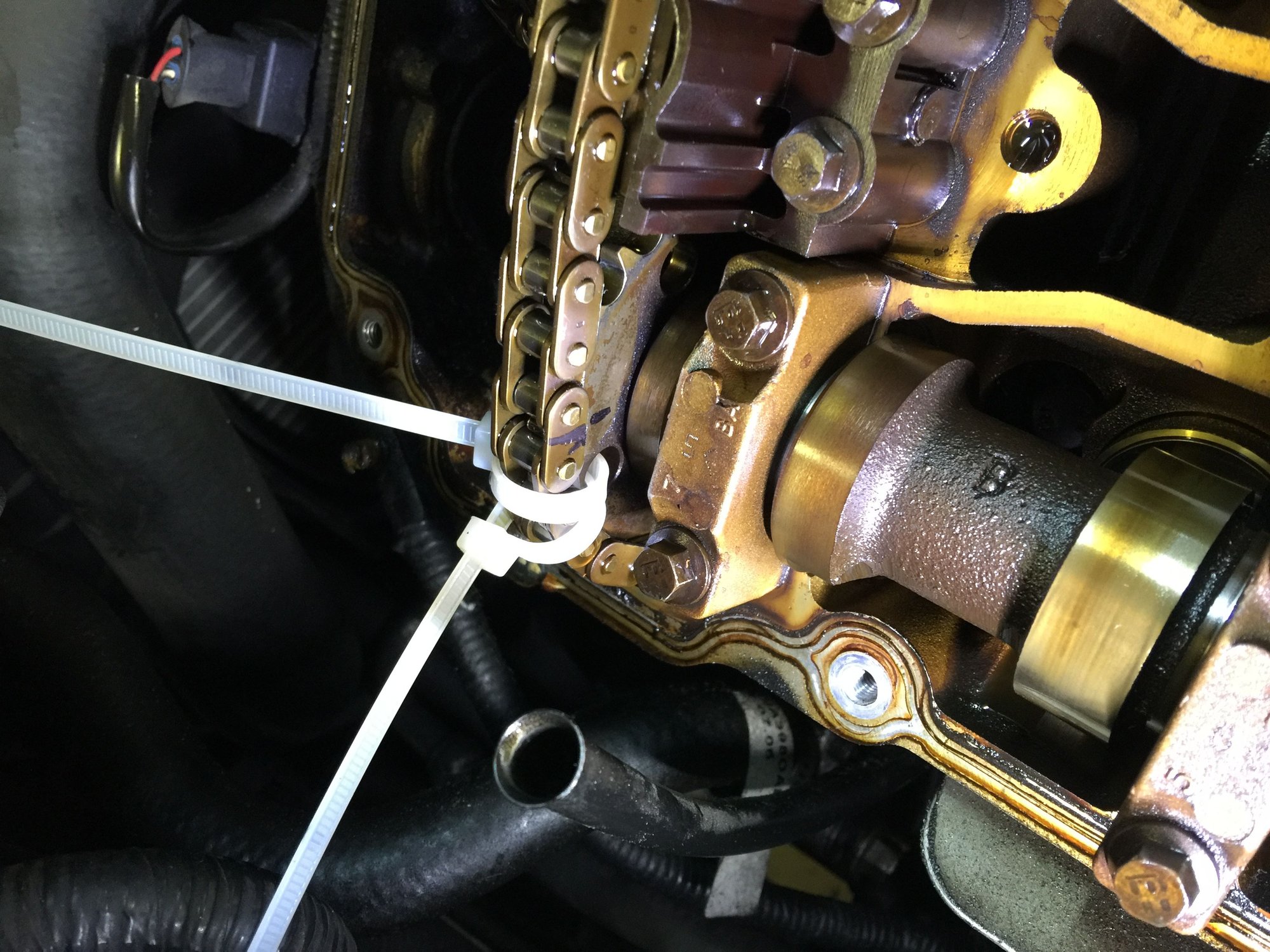

Secondary Tensioners.

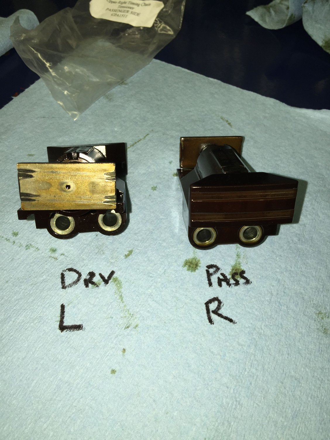

Valve covers removed. As suspected, original ? tensioners, looking slightly cracked and very worn!
I purchased new ones from Christophers Foreign Car Parts via Ebay. Super-fast shipping and good price.
New ones installed using the excellent Zip-Tie method.
I also coated the exhaust cam lobes, bearings and tensioners with Permatex Ultra Slick Engine assembly lube just to ensure a safe friction free start up.
Zip ties and black mark
Cracked and plastic guide totally worn off !
New valve cover seals and new spark plugs installed.

It would be wise to remove the pan and look for pieces of the missing guide in the oil pump pickup screen. That's what usually happens when a guide is missing. It could affect oil pressure.

RJ, that was my thought too. I'll drop the pan and take a look. Plus it'll give me a good excuse to seal the weeping pan gasket.
