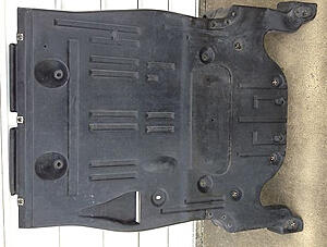

I am not sure if I am correct, but does shield consist of two parts like the pics I have posted earlier? If I could find used one in very cheap price, I would definitely buy it for better result.
The second (larger shield) is bolted to hangers on the frame.
I still would contact www.motorcarsltd.com for used pieces, although shipping the larger may be pricey. Maybe check ebay too.
Skid Plate Skidplate Plastic 2R83-8A095-AC 03 Jaguar S Type 3.0L V6 | eBay <-- what about this skidplate? it looks somewhat different tho.
