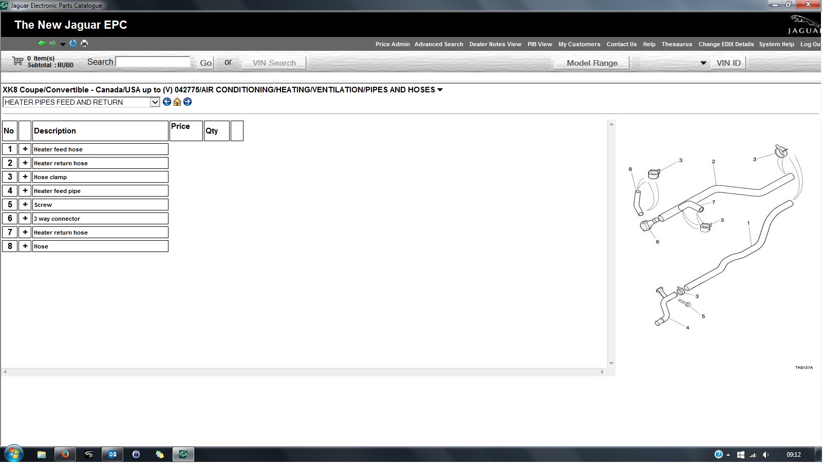

3. Heater Feed
Items 1 and 2

The most regular failures are the Heater Feed and Expansion Tank to Thermostat.
