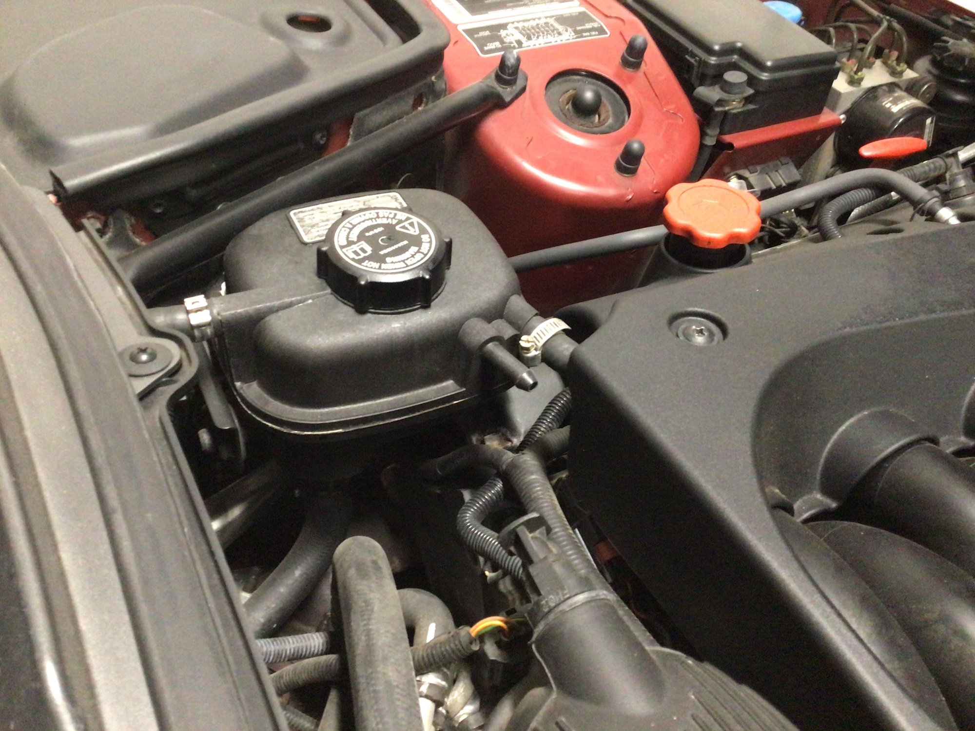

Well I had a low coolant warning yesterday. Maybe 30 seconds. Checked it out when I got home and coolant was about 2- 3” below top of reservoir. I’ll keep a eye on it
but I noticed a fitting with no hose. Am I missing something?

No, you are not missing anything. Your coolant reservoir cap may have failed. When they fail, coolant can get transferred from the reservoir to the overflow tank in the fender well as designed, but coolant often cannot get transferred back from the overflow tank to the reservoir when needed. These mostly plastic caps typically last only two or three years at best. My wife's 2006 XK8 is currently on its fourth cap....

are you saying that fitting with no hose is the overflow pipe? Is there a way to test the cap or just buy a new one?

No, that connection should be blank for your model year (i.e. plugged, no coolant will go through it). The design changed over the years, but the external connection remained...

And yes, buy a new cap.
