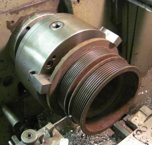

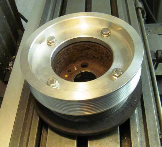

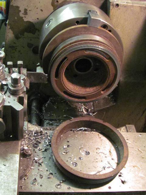

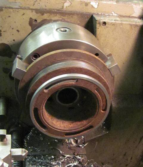

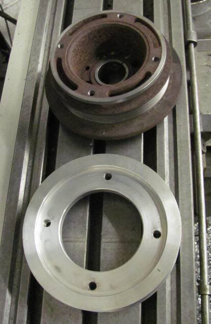

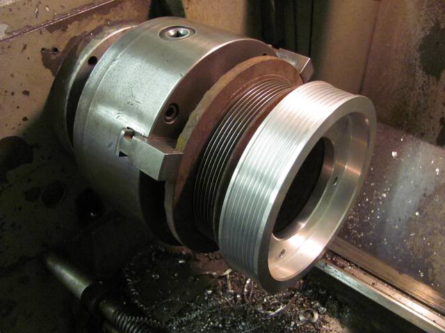

Do you know any machinists?
I just buy the ring and belt and machine the customers own pulley, you would not be without your car then, only takes about an hour to do, turn, drill and tap 4 holes. Doing it this way also works out a lot cheaper for you
