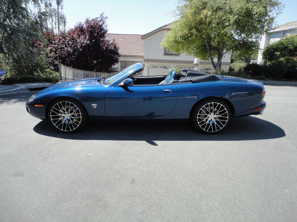

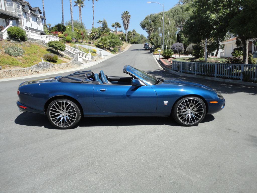

My car is lowered using similar springs. The end result is that it is as low as my Audi S5 is stock. No issues with speed bumps yet but I do have to watch steep entry driveways and the nose will hit a curb (I've moved the oil cooler up to keep it from hitting). Camber adjustments require the adjustment screw and slotting for the front and shims in the back (used Paragon in Europe for them, just send him the camber numbers and the shims dial the car back in nicely). The adjustments took an hour at the shop and you do have to have an initial alignment to find out how much off the rears are to order the right shims. Be aware the car is a lot stiffer at the end but also feels much tighter on corners. It looks much lower.
Below are before and after pictures.

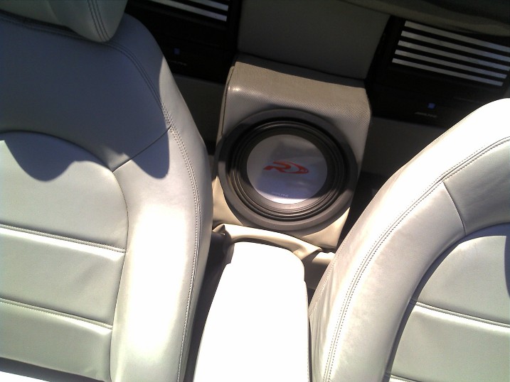

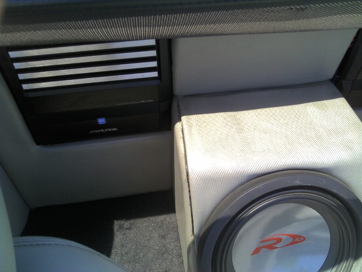

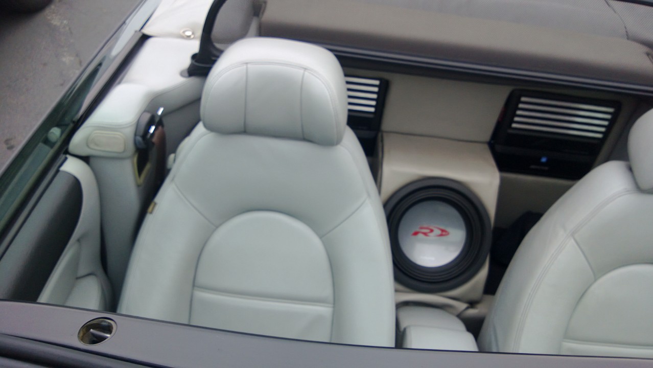

I actually have a couple shots of the back seat delete (I'm thinking of doing this as well).
Attached Thumbnails Lowering Springs-wp_000035.jpg   Lowering Springs-wp_000037.jpg   Lowering Springs-wp_000038.jpg
Old Apr 4, 2013 | 07:29 PM
xenophobe's Avatar
Posts: 1,059
Likes: 134
From: Mtn View, CA
Any chance you could post one or two with a little more of the car in the picture? That looks interesting, but a bit too close up... I wanted to see how it changes the overall esthetic...
Those are all the pictures I took, any others will need to come from Dave. By the way, if it wasn't clear, the car was ordered without the rear seat.

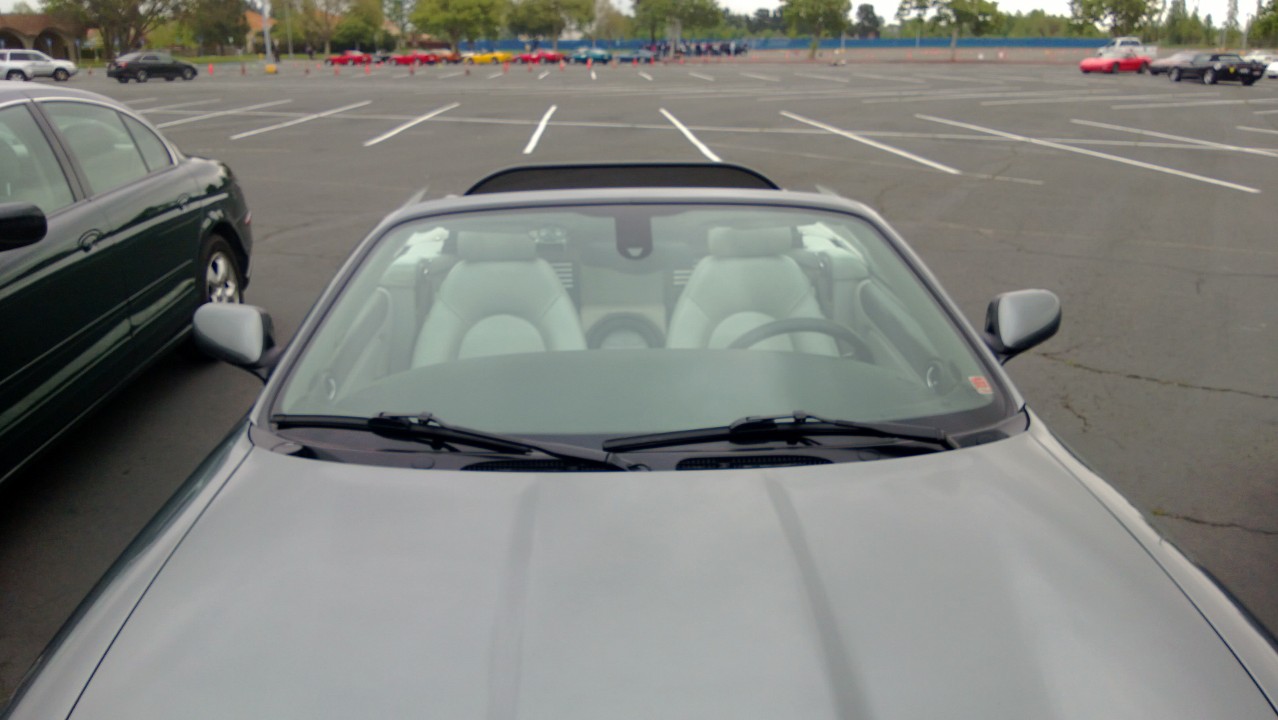

Took some more pictures today of Marc's car (we were on a drive).
Attached Thumbnails Lowering Springs-wp_20130406_001.jpg   Lowering Springs-wp_20130406_002.jpg   Lowering Springs-wp_20130406_003.jpg   Lowering Springs-wp_20130406_004.jpg   Lowering Springs-wp_20130406_009.jpg

I'm not sure what I'm gonna do... I think I want some secure storage for camera gear/equipment and some open storage for just throwing stuff there. Possibly a relocation of the CD player so I can change magazines easier, not sure... I don't think I'll be adding a huge stereo though, and I want it to look sorta OEM and very understated / utilitarianistic...
