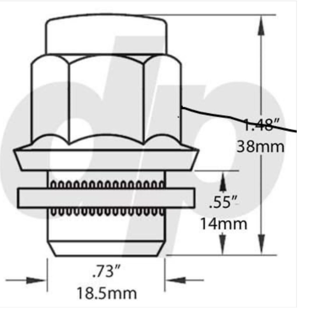

first, an illustration
and second, some conflicting information with these measurements::
QUOTE: “…..Here are the measurements as found on the factory lugnuts
LUGNUTS
1/2 x 20
shank diameter 0.7025"
shank depth 0.4230"M
washer thickness 0.1285" ….” END QUOTE”
I couldn’t find lug nuts with per exact measurements, but the following is a description from a set I purchased on eBay, and they fit perfectly .
I was looking for a “one piece” lug nut because my factory 2-piece nuts (no jokes please) were damaged by an idiot tire installer on one wheel.
eBay listing:
“20 Pcs Cragar Short Mag Lug Nuts 1/2" Washer 0.55 Shank”
This set includes 20 pieces brand new 1/2"-20 Cragar short mag style lug nuts with 20 standard mag washers. Please refer to the drawing for exact specification and size.
