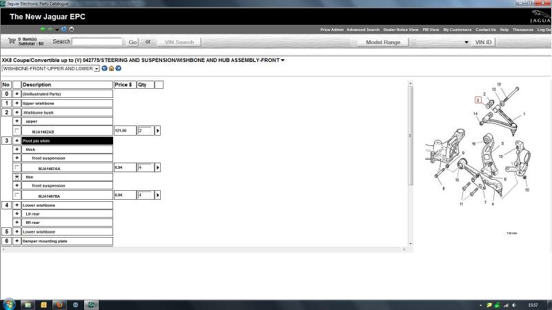

Thanks guys for your help. My spesific car is a 1997 XK8
one more question. is this what I need to fix the play in the aluminum cross member?
Jaguar SHIM THICK FOR FULCRUM SHAFT FRONT UPPER CONTROL - MJA1467AA

Old Feb 13, 2012 | 10:10 AM
The fulcrum shaft should be a sliding fit through the crossmember. If there's any play on it, the aluminium crossmember is likely to be worn. Shims will not cure this.
This is the Parts Manual for the upper wishbone showing the shims and part numbers for the two available thicknesses:
You would normally be able to reuse the existing shims to locate the wishbone correctly on re-assembly.
