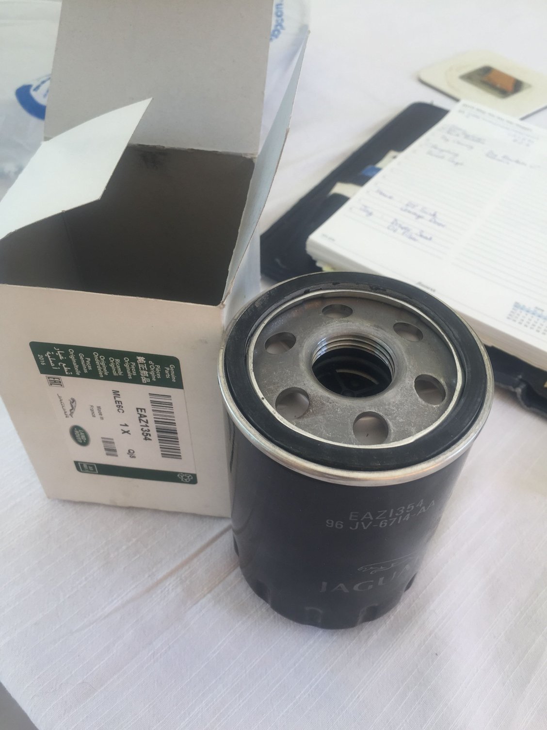

+1 to Truck Graphics suggestion on checking the oil filter.
One of the common faults on home DIY oil changes is the oil filter.
Sometimes when you remove it, the old sealing ring stays stuck in the car. If you don’t notice it, then you’re screwing the new filter in with both rings in place so it’ll leak.
