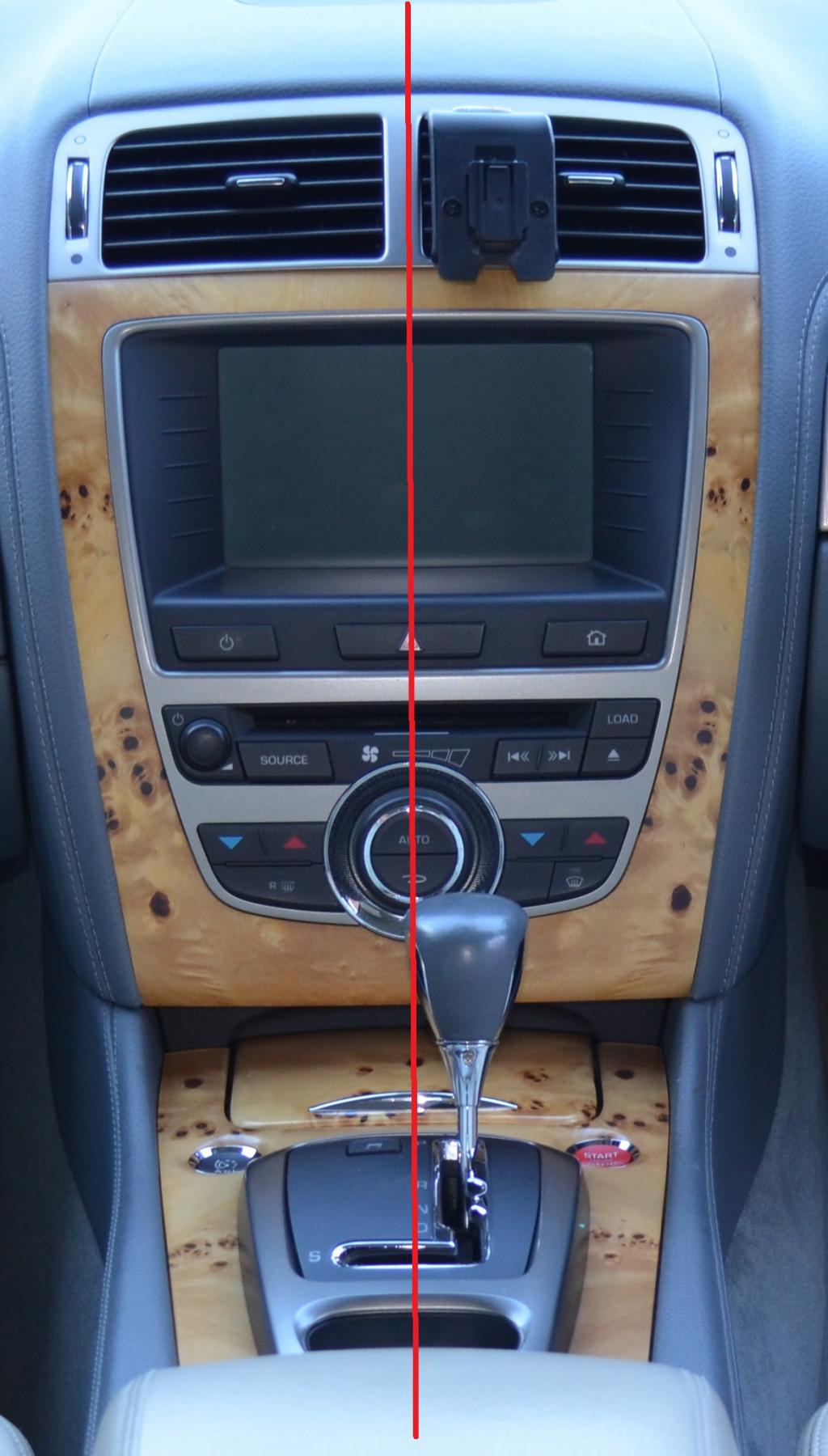

Look at the (original) veneer on any XK8/XKR and you will find it is matched across the facia. Produced from a single length of veneer, the pattern is continuous across the 5 pieces.
Jaguar used to 'book match' facia, door cappings and centre console. The left and right sides of the vehicle were mirror images. They dropped this technique for a time but re-introduced it with the XK in 2007. This is the centre console of my XK. The grain pattern either side of the red centre line I have drawn is a mirror image:
Back to the XK8/XKR. The 8 piece Veneer Set is as follows:
The 5 pieces of the Facia (item 2) are only available as a set. The 2 Switchpack finishers or Console are available separately. If purchased like this, the type of wood will match BUT the grain pattern will not.

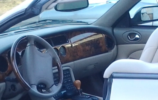

On my XK8 the book end matching created the image of what strongly resembles a Rottweiler staring at you between the airbag cover and the three dial panel, it's pretty cool. If you go to my garage file, and zoom way in on my profile picture (Ctrl + mouse wheel to zoom), you will see the Rottweiler. Slightly fuzzy because of the zoom, but it's there!

......... If you go to my garage file, and zoom way in on my profile picture (Ctrl + mouse wheel to zoom), you will see the Rottweiler. Slightly fuzzy because of the zoom, but it's there!
I can see a horse staring at it from the right hand side of the airbag cover.

GGG, if you look at the split between the three guages and the airbag cover, you'll see the face of the Rottweiler. Half if it's head on one side of the split, and half its head on the other. :icon_banan a:It's actually prety cool!!
Old 09-04-2014, 07:28 AM
GGG is offline
Join Date: Dec 2011
Location: Durham, UK
Posts: 120,407
Received 16,768 Likes on 12,155 Posts
I saw that when I grabbed the pic.
An unusual and effective layout of the veneer. I found the dark finish a bit bland in my earlier X308 and XK8.
