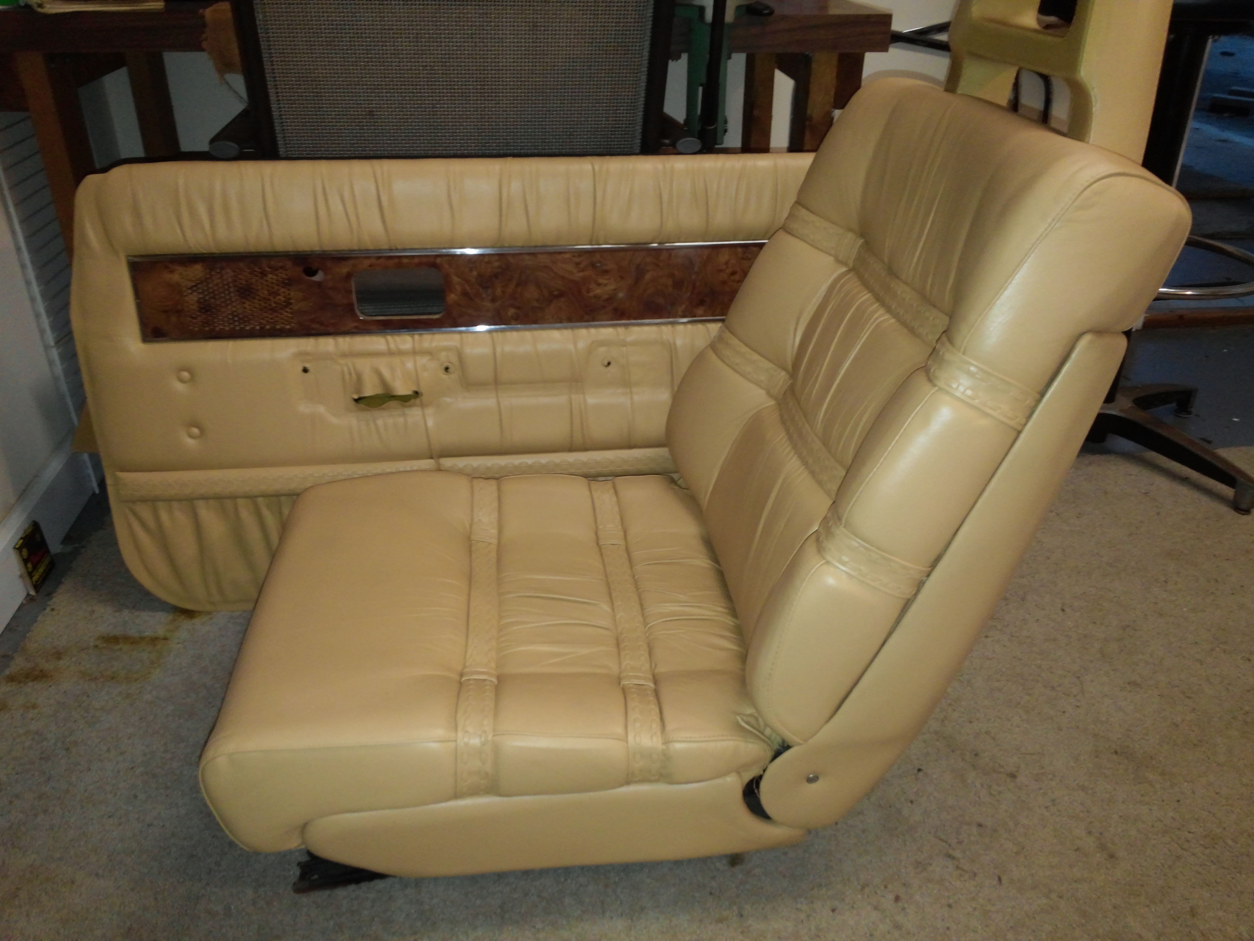

I completely agree with the above but . . . .
You have to accept the fact that automobile manufacturers quit 'dying' leather in the early '80's. Everything produced since is a vinyl 'paint' on the leather. Any of the several products mentioned are probably wonderful and effective if applied to the uncoated side of the leather. To do a restoration of the finish on deteriorated leather involves stripping the finish off the vinyl coated surfaces, then and only then 'conditioning' the actual leather. And then 'repainting' the surface.
Applying a conditioning product to the surface of a vinyl coated surface will not have much of the anticipated affect. The small caveat to that is that vinyl is very porous and some of the magic fluids will get through . . . especially if the leather is all cracked and worn.
I have restored two cars interiors after significant educational explorations. The leather interiors of our cars are a significant part of value of the vehicle. If you think that you can use a spray bottle of magic to restore your leather you should go buy a Prius . . . with a cloth interior.
Restoration of a 34 year old Volvo leather interior.
Volvos That RUN - Chapter 17 - Interior restoration - Turbobricks Forums
Restoration of a 35 year old Volvo leather interior.
