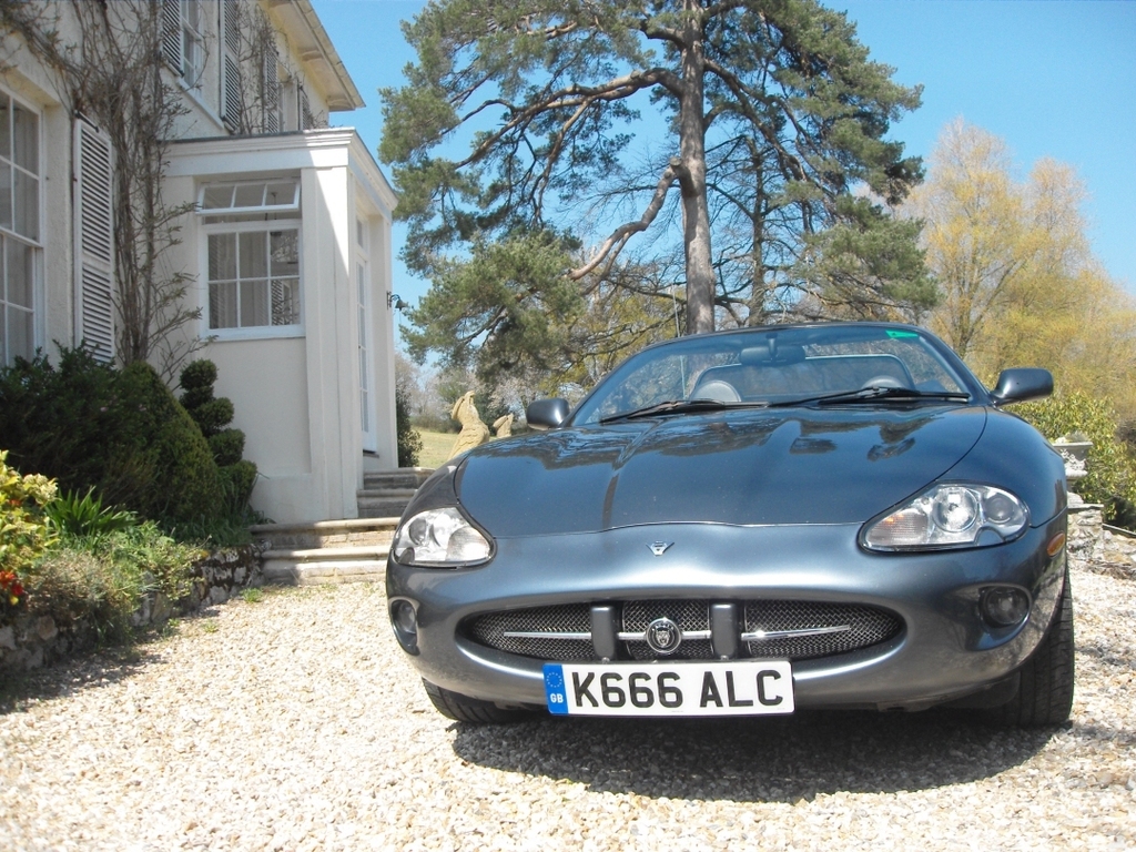

Done by a previous owner, but quite like mine :
Front "bumper / nose-cone" must be removed to install, but as long as the three fixing bolts each side between bumper and wing (fender ?) are not rusted, it's not a particularly difficult job.

There are three bolts either side between the plastic nose-cone and the wing (fender). In the UK these are often rusty and difficult to remove. There are another half-a-dozen or so fixings across the front under the bonnet (hood) which are protected from the weather so usually OK.
Mine is one piece of mesh, but obviously designed to fit around the black overriders.
The centre bar with badge is in addition to the grill and is screwed on from behind. It wasn't particularly well done on mine - you can see the slight "misfit" on the left hand side. That's since been rectified, and I have also removed the cheap $1 from Amazon V8 badge on the front which was hiding the fixing hole for the original Jaguar badge.
Thanks for the compliment, and yes, I assume it the "three piece" XKR style albeit made as one unit.

Originally Posted by pbuck
I think I like the mesh with the splitter bar as well as the overriders, best (as in post #3 above). Best of both worlds.
Thanks - I think it looks good - a nostalgic nod in the direction of the XKE - but was done by a previous owner so not sure I would have done it myself.
It's a personal choice - I don't like the mesh sort-of flush with the aperture, but many owners do, and that's fine by me !!
