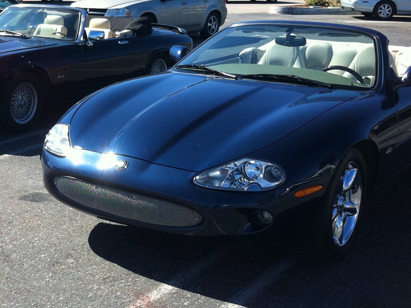

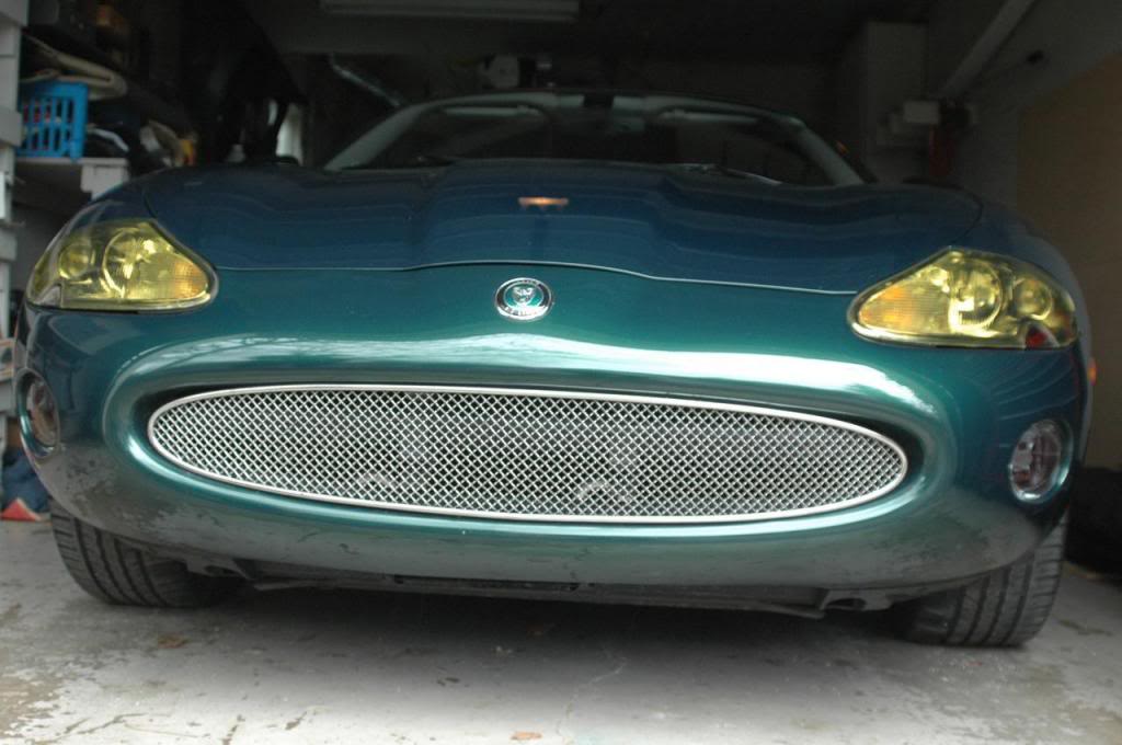

After seeing theweeb's picture I think I am staying with the stainless. It looks good on a dark color. I guess it's just a matter of preference. Some like blondes, some like brunettes, some like them all!

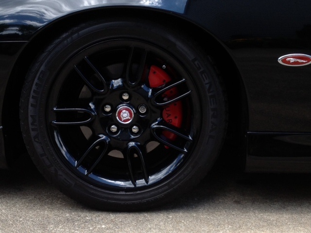

Perhaps it has something to do with the wheel color. I think they look better than the original ones on my style of wheel. Also the Adamesh lug nuts in this pic.
They do look great on those wheels.
I just remembered I have a set of those new growlers in red I bought for my XF. Maybe they'd look better on mine as well. I really kinda like the older growler on my black wheels though.

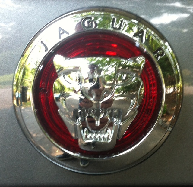

Also, here's a pic of e side view of the new growler. It has a beveled back so when you snip off tabs and use 3m tape, it will have a cut back lip on the car. Very easy to pop off is some shady person wants it! I lost one first week. And the fact that it won't sit flush on the nose really bugged me.
And just a cautionary note, the newest new growler won't fit in the adamesh bezels. The growler with the black sunburst background.

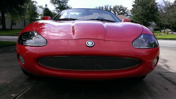

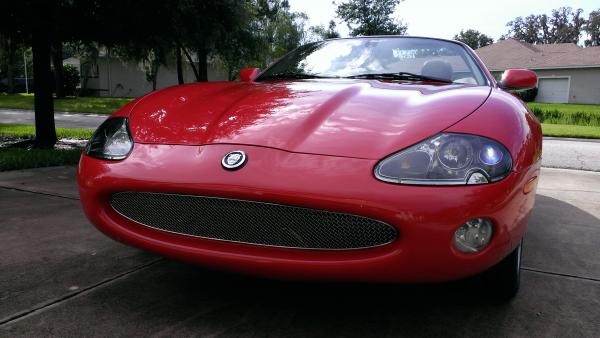

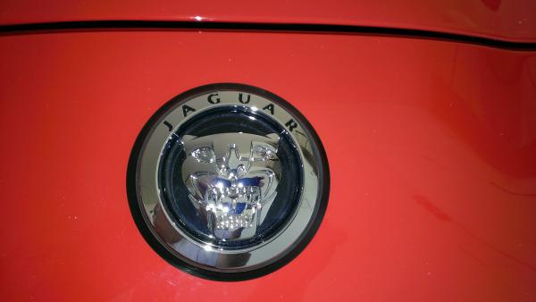

I finished installing the adamesh grille. Decided to leave it stainless. Installing this one piece grille was quite a job on this 04 model year. About 8 hours including all the cleaning I did since it was apart.

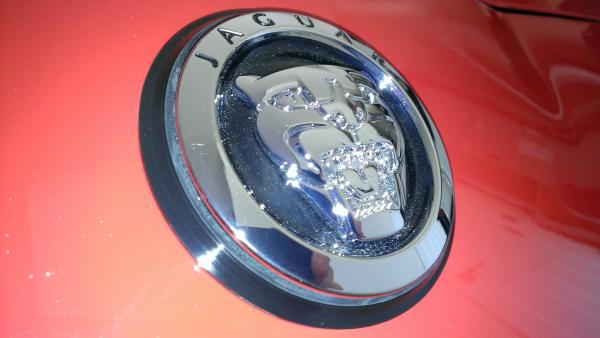

Also installed the new badge while I had the bumper off. That took me a few hours but most of it was for fabricating the black bezel.
I am really happy with the new look.
Before:
After:
Badge Detail:

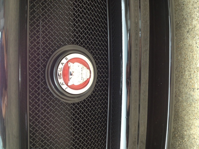

Ha ha!! I painted my bezel today too!! Hated it chrome.
I'll agree on your car that badge looks great on the nose. I just wanted mine to match my XF grille.
Bezel looks awesome!! How'd ya do it!! Also really like the chrome grille on red.
And you can always paint it if you ever get tired of it!!

I like the look - not as overpowering in the stainless as originally anticipated - nice job

Yours looks much better black. Nice work!
Because the nose is not completely flat under the badge, I used a polyurethane hydraulic seal and cut the center out of it. It has that smooth machined look with sharp edges but was soft enough to handle the bend and fill in the gap.
So the bezel is just stretched over and snapped around the mounted emblem. No need to glue it.
I thought it was a genius idea.

Yes, it looks awesome! Source? Part #? Cost?

Genius is right!!

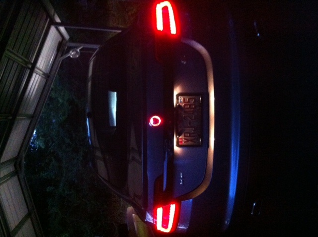

I was brave and ripped off the leaper off the back of my XF and made a lit growler badge!
I hate my iPad flips my pics!!!!UGH!!

Emblem came from Welsh Enterprises About $27
Polyurethane "bezel" came from M&W Hydraulics in Tampa. It's an SKF seal. Part# FSU25-2.50-SQB. About $7 You'll also need a dremel to cut the center of the seal out.

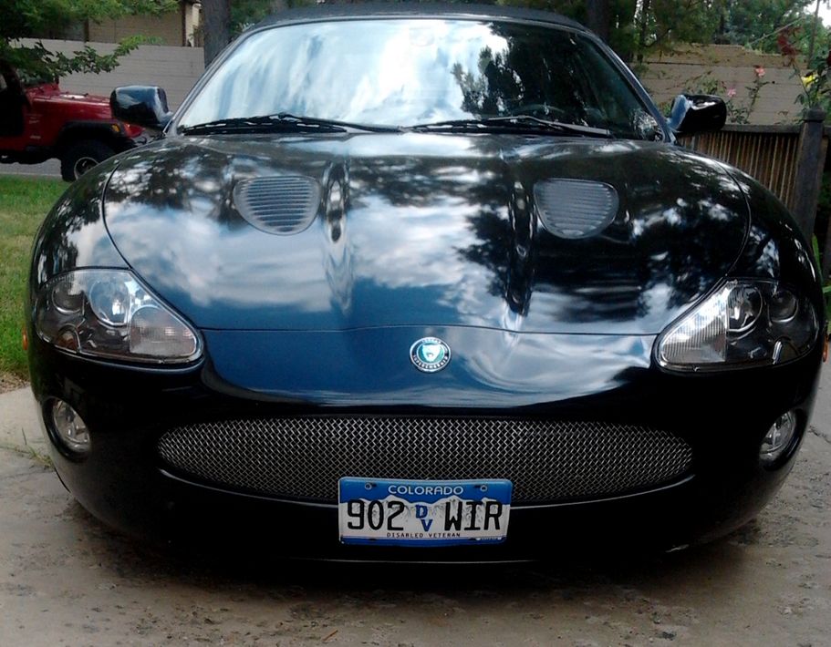

I could not bring myself to mount the plate in the center, so used the lower holes for the upper part of the plate. I just did not want the plate to dominate that awesome mesh!

I'm soooo glad we don't have front plates in NC!!
