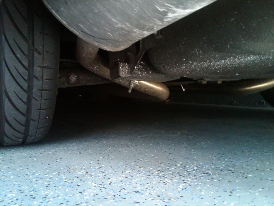

I have the Mina exhaust installed on my car. I've never lowered my car because I have been worried about that myself. If your exhaust sits lower than mine, you should have it readjusted. I have never bottomed out on any speed bumps with this set up. (knock on wood)
Danster- Does the pipe touch the bar above where the arrow points? I cannot tell for sure from the photo.

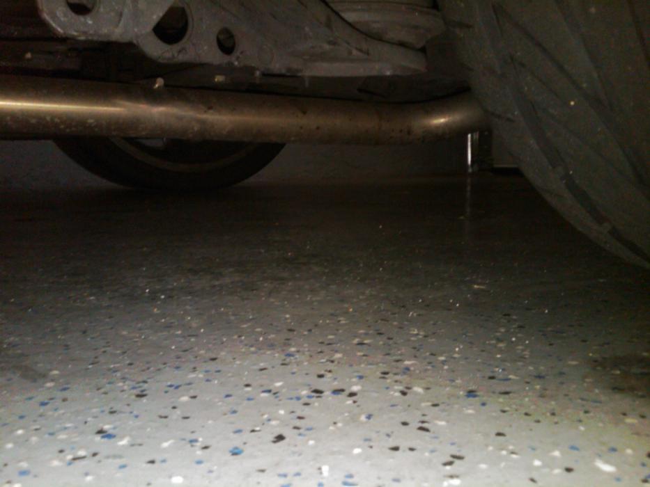

Old Mar 7, 2011 | 01:43 PM
Danster's Avatar
Posts: 74
From: Northridge, CA
Mine appears to hang just below the connection of the tie rod. The lowest point of the exhaust hangs about 4.5 inches above the floor. Hope these pictures help.

Danny- I think you may have the 'low' mounting also. I will post some pictures tonight and describe the procedure to raise it. It is not too difficult.
