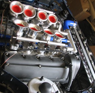

I think the whole point was the quote "without being loud and spending a ton of money"
I mean if you want to spend some money, you can do what I did to my XK8
That will beat most XKRs

Lawdy, I had no idea that was an XK8 engine. What's a set up like that go for? Do you have an opening in the hood for that?

I guess if I was to do this setup for another XK8.........
The prob you have is the knock on effect, you can't do a setup like that without changing the ECU, well I would not of thought so, as I also fitted much larger injectors. You will probably also notice there is no Tstat tower, no water pump either
They are now both electronically/digitally controlled, I can speed the water pump up if I wish to cool or slower to run hotter, my other option is to just set a temperature and let the control box maintain it.
This meant a stand alone ECU which of course is not going to work with the TCM, so in goes a manual tranny, then you have the instrument issue which there might be a get around if you could duplicate the inputs it needs or you replace the clocks.
Anyway $25K later you wonder where it is going to stop
The air intake is the big hole in the hood
The hood actually acts as the top of my air box, OK it will once I get around to making it
