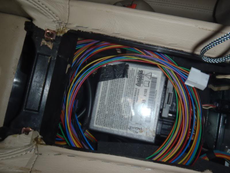

Just put in a T605 for blue tooth through the radio. Not very hard after I figured out the pins on the connector. I have a 2004 with the 18 pin yellow connector.
pin 4 is battery
pin 5 key power
pin 6 is mute
pin 7 is audio +
pin 8 is audio -
As with everyone else the Orange and yellow wires are miss labeled in the installation instructions.
A nice feature of the Jaguar is that the radio does not have to be on for the phone blue tooth to work through the speaker.
So, can anyone tell me what the latest set up for auxiliary input is? I would prefer to do something non destructive to the CD player.
And, where can I find a male connector that matches the Jaguar phone plug?
Here are a few pictures of the install.

Are your sure you are counting the pins correctly? Are you referencing the numbers embossed on the conenctor? Double check the colors match on the Jaguar's harness:
pin 4 is battery Brown-red
pin 5 key power Green or Red/White
pin 6 is mute BLUE
pin 7 is audio + BLUE
pin 8 is audio - BLUE-YELLOW
pin 11 is ground BLACK
pin 1 is Mic + White
pin 3 is Mic - Green
Pin 2 is mic shield

My harness is as follow as per little small tiny numbers on the connector
pin 5 key Is empty
pin 6 is mute Blue Ignition
PHP Code:
YELLOW
Pin 9 is blue/yellow supposed acp
Pin 10 is green/yellow, supposed acp
Pin 16 is red/white, supposed mute
Pin 2 is mic shield yellow
I think i solved the mic issue. The oem mic impedence is 100 ohm or so above the t608's. However, that should relust in higher level and therefore work fine, if i m not mistaken.
Still no sound through the radio, but the motorola speaker works.
Still searching, ideas welcome..

I'm betting your problem is a crossed wire. I will look at my installation later. I believe that the microphone only exists if your car came with the jag phone installed. Once I got everything worked out the device works great.
Bill
Old Dec 31, 2011 | 06:59 AM
Thisch's Avatar
Posts: 13
From: Qatar
You were right, Bills. 5 and 6 were crossed. 1 fuse and a couple of solderings later, the mute works fine, but still no audio in the headunit, and nothing from the oem mic.
