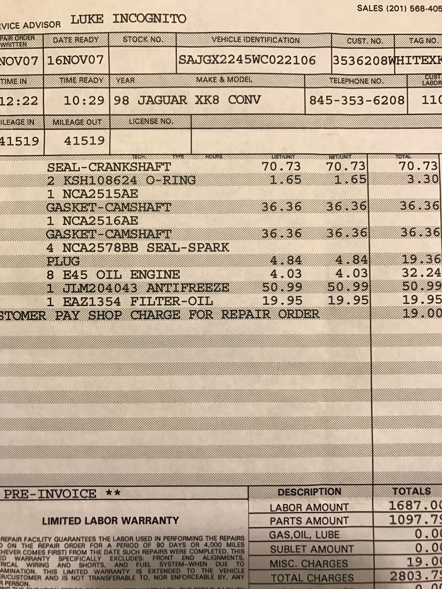

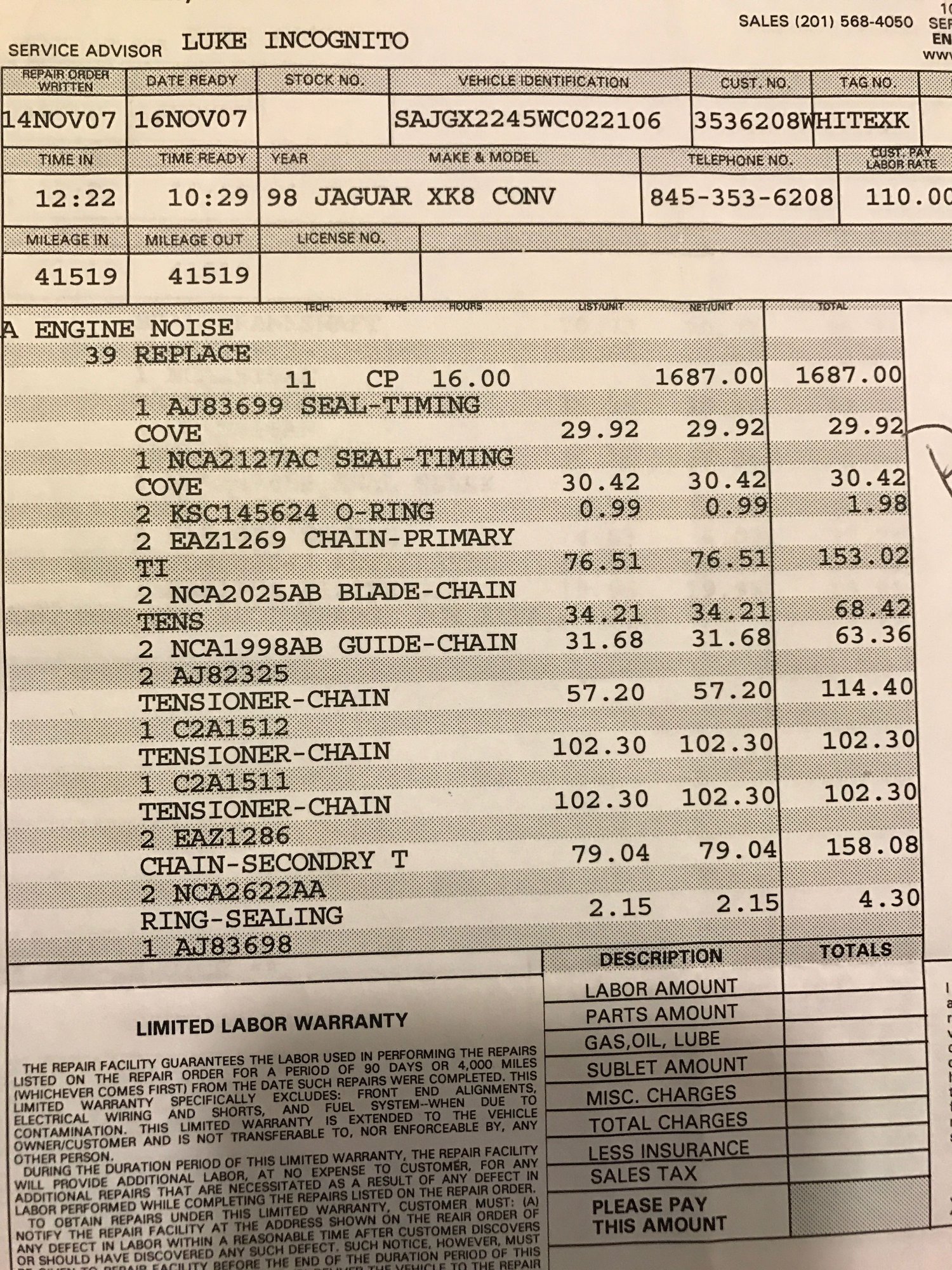

I pulled the service records for my car. I bought the car from the original owner, and he had the car serviced exclusively by Jaguar dealership.
Take a look at this service record.
What do you make of it?
Work was done in November 2007, and the car only had 41,500 miles.
Today, I only have 51K
Your thoughts?

Looks reassuring. Had the full monty.
Not impossible, but hard to imagine 3rd gen tensioners failing after 10K.
Did you try the cold start with the serpentine off?

if anything, a useful shopping list for anyone looking to do a complete tensioner job
