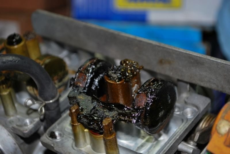

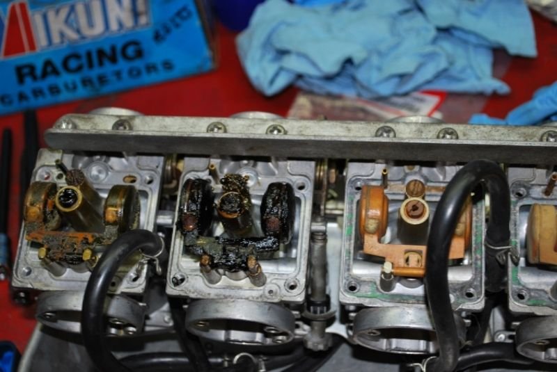

Take the air cleaner element out and check for free airways. Mice, squirrels, and other assorted varmints do enjoy a nice quiet place to set up housekeeping. It’s a lot easier to deal with such an occurrence before trying to start the motor than afterwards.
Personally, I would be draining all the fuel from the system first, and putting in fresh gas. Srabil
and other such products are only so good….But there’s many schools of thought on that. Here’s what pure gas looks like in a carb set that’s sat too long
Z
