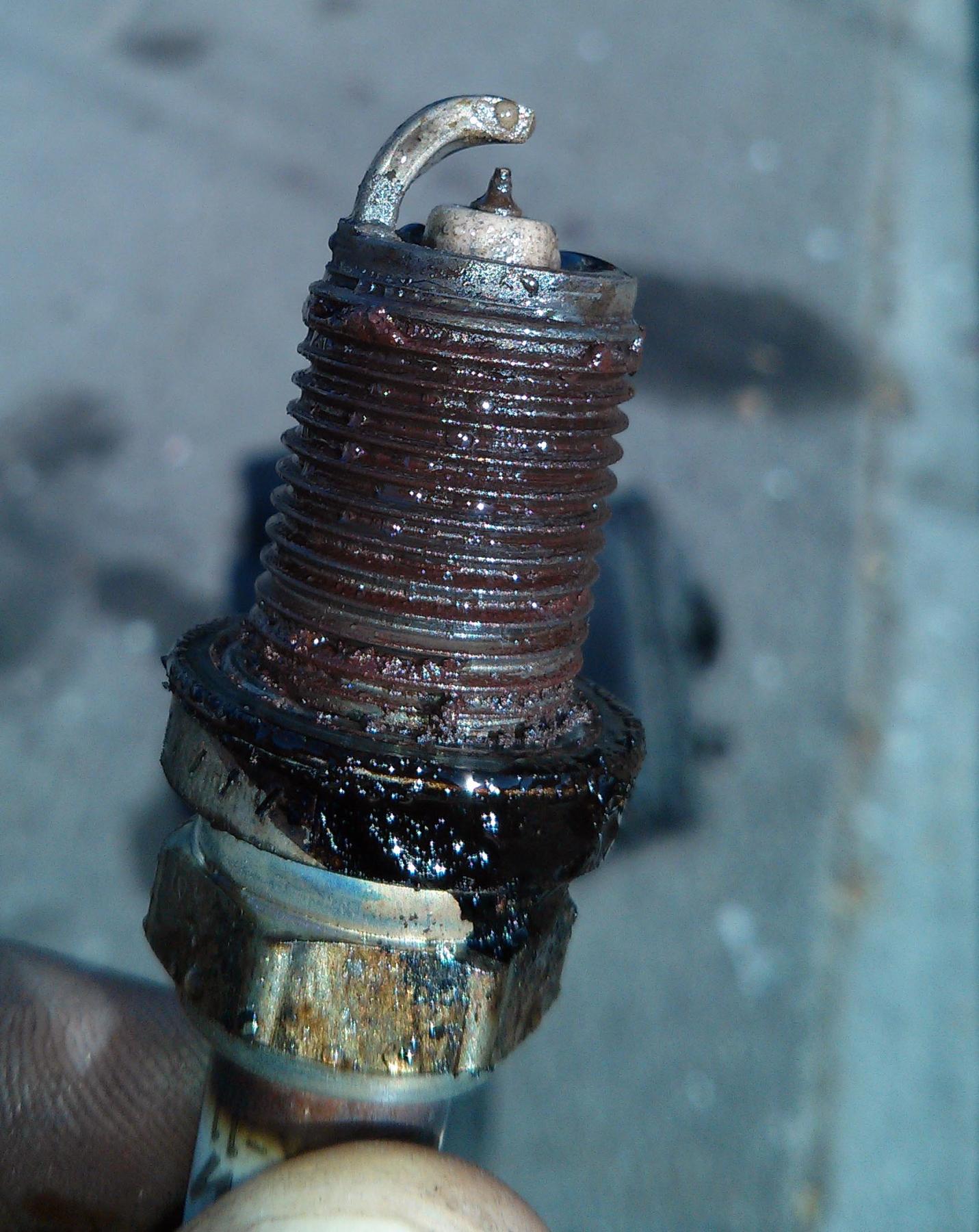

Removed all the spark plugs: def water and oil (they already needed new gaskets) on most of them:
I posted in another thread about how to do a compression test, would the following steps apply in my case?:

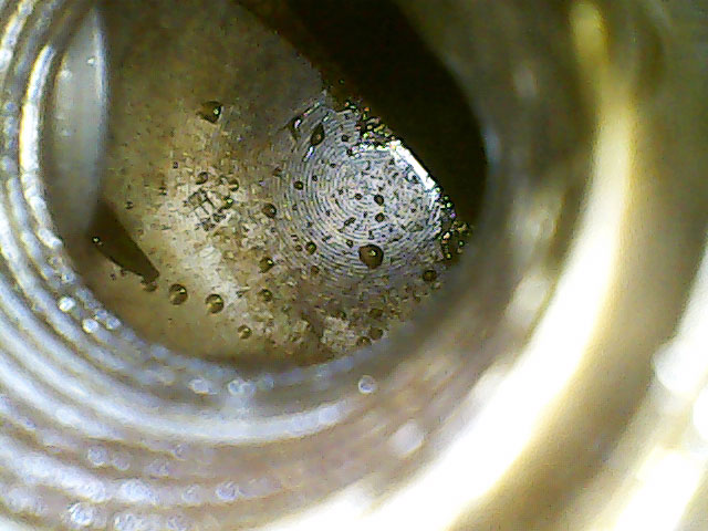

Tested the endoscope, works great! Def some water there. Looking forward to filming my cranking attempt, which can be done by one person.

Battery re-charged, cranking out water (using endoscope cam):
Then did a compression test (results jumped 10-30 psi adding two small caps of oil to the cylinders). 6 cranks is enough to max out pressure.
Holding down the gas pedal or keeping the throttle body open with a screwdriver gave the same results.
  1. 120
  2. 90
  3. 80
  4. 90
  5. 122
  6. 92
  7. 80
  8. 120
Then tried to start the engine with plugs and air intake manifold back in:
There's also another coolant leak demonstrated by a couple of puddles under the engine (not oil though).
Things are looking pretty bad. It would be really helpful if I could drive it across the st though, any thoughts on coolant leak sealants?
Forgot to film the cranking in action.

Water in the cylenders+the compression readings= heads are coming off. They will tell you the whole story. Safe to say you don't have dropped valve seats as you would have 0 compression readings where the dropped seats were. My uneducated guess is that you will find the head gasket compromised in 5 cylinders. You have an 80% chance the car will run fine after you replace the head gaskets. 20% chance of greater damage, but that is diminished by the fact that there were no dropped seats. (not SEVERELY overheated)
