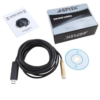

So one person tries to start the engine, and the other ones peeks into one hole at the time (sounds dangerous!) What about using a USB endoscope btw?
Amazon.com: 16ft USB Waterproof Endoscope Borescope Inspection Camera with 4 LED lights: Home Improvement Amazon.com: 16ft USB Waterproof Endoscope Borescope Inspection Camera with 4 LED lights: Home Improvement
I'll commence the craigslist search, if not money, I do have time..

an endiscope or borescope would be ideal, but some of us poor folk only have a spark plug wrench and a helper
The engine really does not turn that fast when you are just cranking it (all spark plugs out and injector relay out of course) Alternatively, a compression check will tell you alot... and you can use that by yourself. any 0psi readings= head comes off.

WOAH, I just looked at that ad- $24? I am getting one of those like today.
