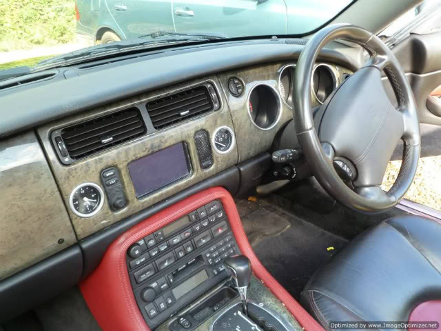

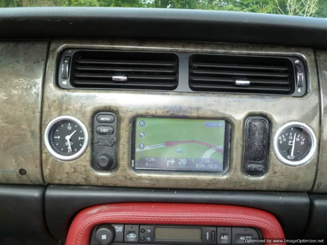

Like just about everyone else I despaired of the Jaguar satnav, so have replaced it with an in-built touchscreen/bluetooth system. This is not integrated with the Jaguar system.
I removed my original unit and fitted a 5" touchscreen Tomtom, which fits just perfectly behind the veneer. I removed the right hand buttons and installed a 4-amp speaker, below which is the microphone from the Tomtom and a button to re-set the clock. To the left hand of the scree, the top button turns the system on and off, below that is a USB output, and below that a button to switch the Satnav from internal power to USB connectivity (so that I can update to a laptop). The bottom button has been turned into a volume control. To do all this I had to open up the Tomtom, which of course invalidated the guarantee immediately, but taking microphone, speaker and on/off wires was actually very easy.
Total cost should have been about £270 (real UK money!) but it actually cost me about £450, since I (ahem) somewhat buggered up the first Tomtom.
In the space to the left of the unit I have fitted a 2" clock, and to the right of the unit I have fitted a 2" voltmeter. Since fitting them I have had matching 2" aluminium rings made and will be replacing those instruments with originals from the 3-clock system (they'll look ok, because they are set back and do not suffer by being behind a smaller ring than original). Since the sound quality is not great
I am putting in a small amplifier and bass/treble control, and I'm thinking about installing a swan-neck microphone to improve the telephone.

Hi, Malbec. Here are a couple of photos, as requested. When I've re-done the instruments with the originals I'll post a new thread.
The speaker grill will be re-painted before the job is complete, as well as new instrument rings.
