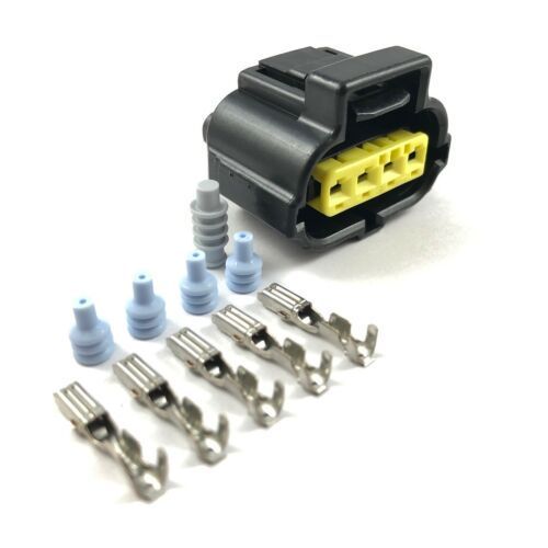

Have a 97. I've been going crazy trying to find a 4 prong pigtail for the throttle position sensor. Anyone have a part number or a diagram with part numbers or.... Someone suggested a Toyota crossover. Nope, different size, but only slightly. This is driving me nuts. TIA!

Is this what you need. This is for the AJ27 TB. The pigtail is available. Try Ballenger Motorsports they should have what you need. This connector was also used by Toyota and Lexus I believe.

At least for AJ27, per above, I think it is a 4 Way SSC Sensor Plug Connector Toyota # 90980-10711 from Ballenger Motorsports (or other Toyota parts source) - might also be Digikey 184046-1 but can't be 100% sure since I've never ordered it from them
You may also need the gold plated pins, which can be sourced from Digikey (in USA not UK) part number 171662-5. I'm not sure if the '97 suffered from the dissimilar metals corrosion issue due to gold plated connections on the throttle body connector socket (my AJ27 2001 certainly had that issue until I changed to gold plated pins for the plug).

I think this is the same as what I tried before. It must fit later models than my 97 as it was oo small in all dimensions by a little bit. I have the AJ26.
