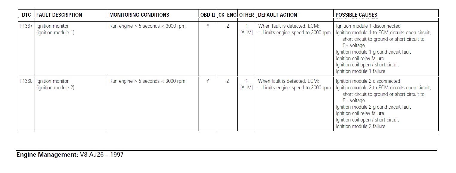

I have a 97 xk8 with around 40,000 miles ,car start then shut offs . The codes are P 1367 and P1368 . Can anyone lead me in the right direction on this . Thanks Ksnowcut

Look up this thread:
How common is the P1367 fault code (XJR 1998)?
item 4 and 9 seem to fit your issue. I am not an XK8 guy, but I think you have an aj26 motor.

Here's the extract from the Jaguar Diagnostic Trouble Code listing for the relevant codes:
