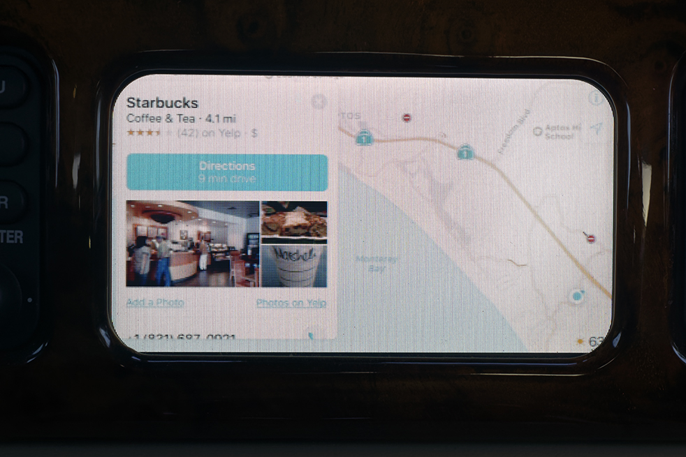

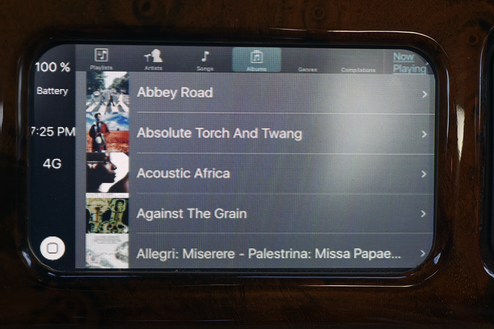

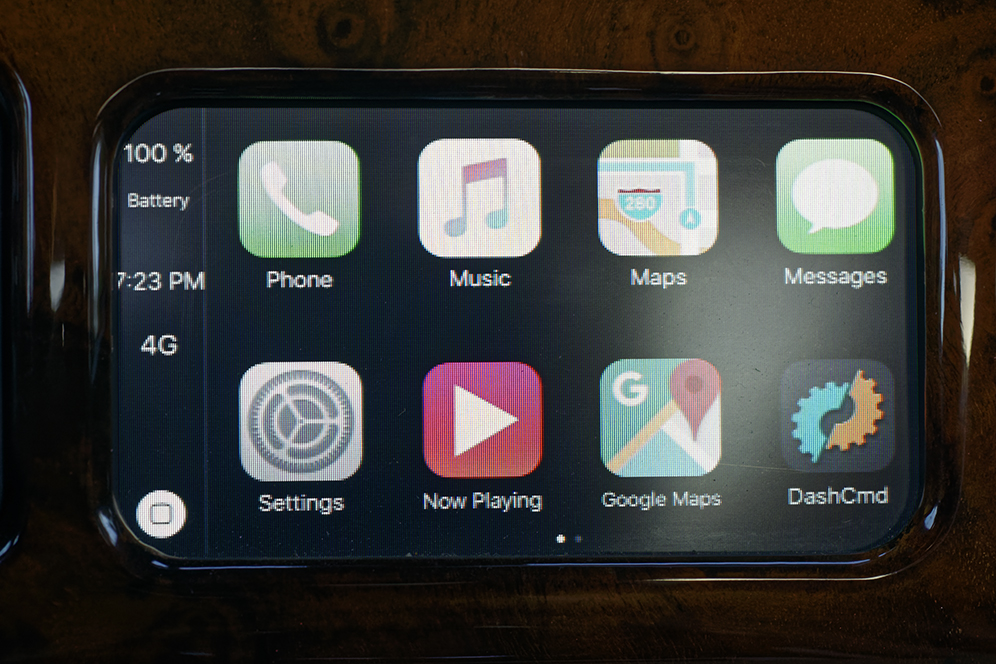

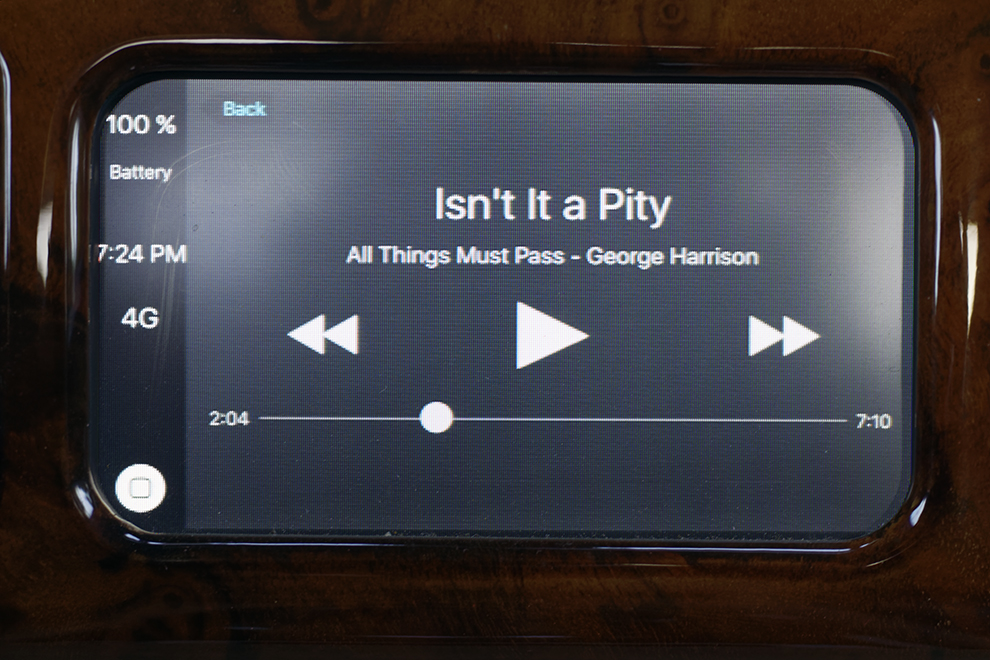

I recently installed NavTool 3.0 in my 2005 XKR coupe. I have an Apple lightning cable coming through the change holder in front of the gear shift. When I connect my iPhone 6 Plus, whatever's on the screen is mirrored on the car's navigation screen: Apple Maps, Google Maps, Phone, Messages, Apple Music (iTunes). In addition, whenever the car is in reverse, the video automatically switches to a Pyle rear-view camera that I have mounted at the top of the license plate.
Finally, I have a PLX Devices Kiwi 2 WiFi OBD-II unit with iMFD Adapter that lets me use the DashCommand app to monitor (on the navigation screen) battery voltage, coolant temp, oil pressure, and supercharger boost using a dashboard I created on the DashXL website.
The phone charges while it's plugged in; I can listen to anything in Apple Music (my iTunes library) through the Alpine premium sound system. NavTool's installation instructions assume you have a Denso nav system; since mine was an Alpine, I had to figure out the connections for myself. I'm hoping to post a detailed "how-to" in the near future.
