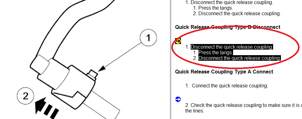

Hi.
To disconnect the lines in the engine compartment and by the fuel tank you will need the tools.
To disconnect lines by the fuel filter I don't think you need any tools.
Release the fuel pressure first.

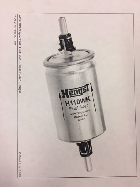

Thanks for your help. I was able to get the connectors off finally. I got the white tab to move with firmer pressure with my thumb and gentle wiggling released the quick-connect.I did actually release the pressure in the fuel line as mine has the schraeder valve on the fuel rail. I think that might have helped to release the pressure and let the white tab move more easily. It was a little tight working around the suspension with the car up on ramps. I wonder if it would have been easier to access the filter with jack stands instead of ramps. But with some contortions I was able to get to it.
I saw that many other threads recommended a Purolator filter from Advance autoparts. But my local Advance autoparts found what they said was an OEM part by Hengst. It was $10.33. So with the $39 ramps and the $10 filter this was a whole lot better than the $217 that the jag dealer in Denver wanted to charge for replacing the filter. I'm including a photo of the Hengst part below. it was a perfect fit in the cage and seemed to seal perfectly with the quick connects.
Thanks again for all of your help everyone.
