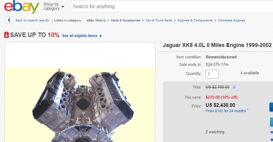

What has me wondering if the 98 is different is that I see several ads that list 1999-2002...but make no mention of 97-98
Also wondering why the VIN is important.
E.g. "1998 JAGUAR XK8 Engine (4.0L), (VIN 2, 8th digit)"
BTW - Visited Raleigh for the first time a few weeks ago. What a lovely city.

Commiserations - sounds like something fairly mechanically traumatic has occurred.
Lots here will have more knowledge than I do, but I think it's always going to be easier to replace like with like. There are significant differences between early (97 - 99 ??) engines and later developments, all of which will have an impact on stuff like ECUs, TCUs, wiring looms, etc etc.
Main (and easy to see) differences are :
Position of variable valve timing solenoids
Vacuum or electronic cruise control (black plastic reservoir on top of the throttle body)
2 pin or 4 pin coil packs.
EGR valve or no EGR valve on throttle body.

You need to replace with a 4.0 litre unit (AJ26) as a direct swap. If you find a used engine, be sure it has new primary and secondary timing chains, guides and tensioners uprated to the latest design.

As NBCat stated, the AJ26 will not require swapping parts to get the engine to work correctly. Any Normally Aspirated 4.0 V8 from a 1997-98 XK8 or 1998 XJ8 engine will bolt right in.
