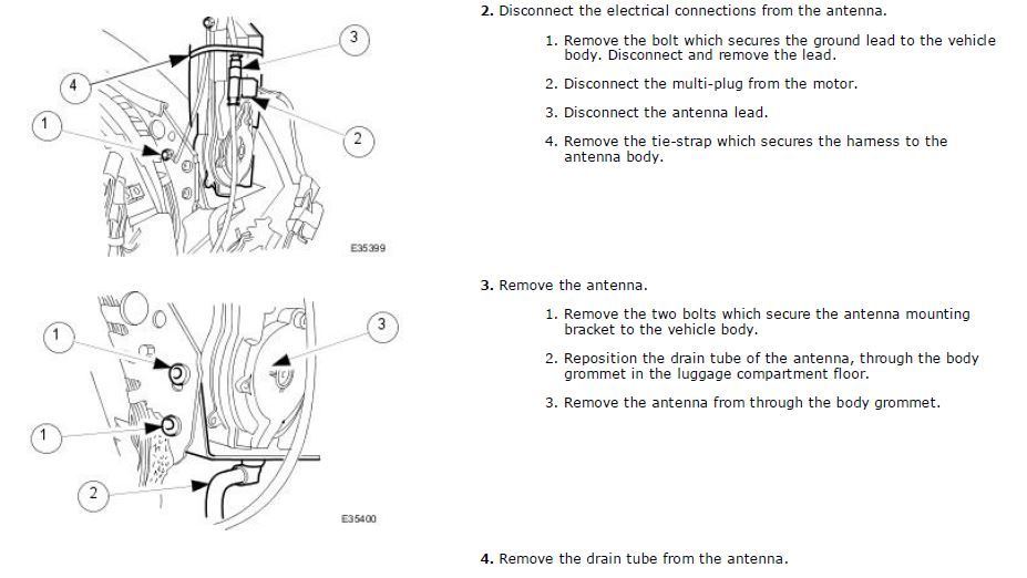

Need to remove antenna motor on a 2003 XK8, was wondering the best way to do that. Mast is already removed and the mounting screw is removed and the ground screw is removed. but seems stuck.

is the drain tube still attached?

Did you get all these?
