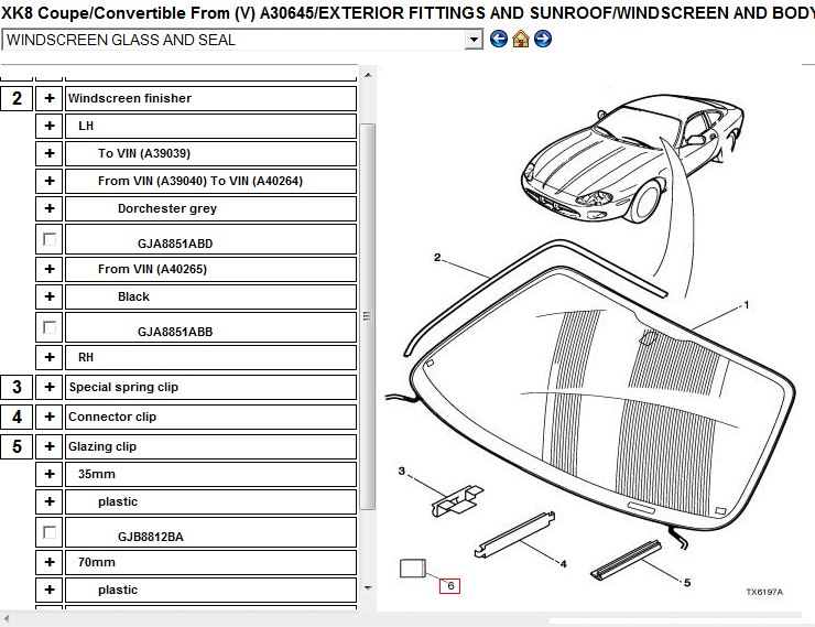

In addition, the rubber edging around the windscreen is cracking/cracked. This appears to be under a grey metallic painted strip. The windshield company tells me that the part they can't get is
GJA8851ABD (shown in the attachment from JPEC). The diagram isn't very clear - is the seal included with this part (the LH finisher?). They've also told me that all the required clips are included with this part (and the equivalent RH finisher) - looking at the diagram, I don't believe this is true. I'd like to let them know this is the case, but can't tell from the picture which are the white clips they need to order.
Thanks in advance!
-Steve

When Safelite replaced mine, they brought new replacement clips with them. What is not replaceable is the grey moulding strip around the windshield. But replacment clips are available.
Thanks. Are the clips they replaced the white plastic ones? (they looked about 5" long while they had the trim piece off.
The hard grey plastic strip around the windshield is ok, but the rubber seal that is under it (and I think supplied with it) is cracking on the inside edge where lays against the glass, with pieces missing from the edge - they are having problems getting hold of this (LH side - apparently they have the RH side). They say the clips are included with this part, but I'm concerned they are looking at the wrong clips (when the guy arrived with the factory windshield he didn't have any clips).
-Steve

When Safelite arrived late six hours on the first day, the technician arrived without any clips, and he attempted to call another installer who supposedly had them. The second installer couldn't be reached and they rescheduled for the next day. They showed up, both the first installer and the one he had tried to reach, and as I recall they brought long white clips with them. The extraction of the old windshield was difficult as some of the adhesive had leaked through the rubber gasket and had attached the grey trim piece. They had to saw through the adhesive with a wire to separate the windshield.
After it was done, it was such a pleasure to have an unpitted windshield. But, that only lasted 2 days as a rock bounced up and chipped it right in front pf the steering wheel. I had it resin filled by Safelite, but I still see it everyday.
