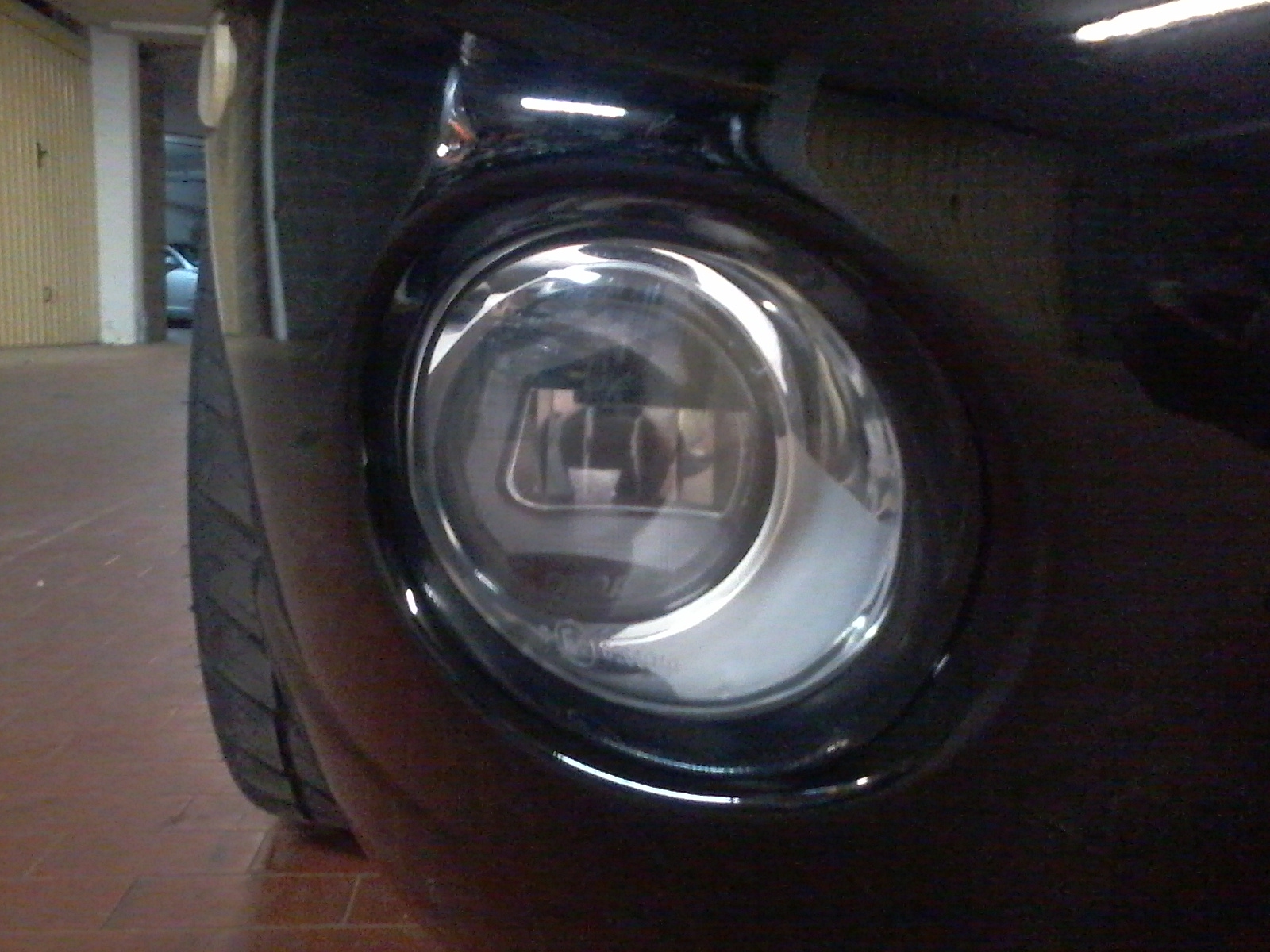

these are the headlights installed! just beautiful!
apply these lights is relatively simple. You have to remove all brackets by OSRAM headlights, remove the parable to the OEM fog light of the car and insert the original rubber on the new lighthouse.
Are then used 2 screws 4 mm long 10 mm,metallic thickness with 6 mm hole diameter of about 5 mm high (for this purpose I used 2 dice with 6 mm hole). Finally you need 4 large washers with 4 mm hole ranging filed in the stirrups to be collected in plastic original lighthouse.
Tomorrow I'll make the electrical connections and finally I'll make a video with daytime running lights activated

So, let's start with the make one thing clear:
when the lights are lit in front of a lens, it has an overexposure of light and therefore does not distinguish the daylight that has a shape of a "C" and the fog light central rectangular. I've seen other videos on youtube and when you turn these lights all the cameras go overexposure and therefore we only see light without details.
In my video, it happens in this sequence:
1-opening car: along with the flashing arrows also daytime running lights
2 - turn on Power panel : automatically turn on the daytime running lights
3 - switch position lights: daytime running lights automatically turn off
4- power on low-beam headlamps
5- turn on arrows: with the lights on when you insert the arrows you turn on the fog light on the same side
6- turn on fog lights
7- turn on arrows Emergency: blink along with arrows also daytime running lights

Old 08-14-2014, 03:57 AM
User 070620's Avatar
Join Date: Jan 2012
Posts: 1,462
Received 301 Likes on 148 Posts
I forgot an important detail. with these lights you can leave the light switch in "auto".
are normally turned on the LED daytime running lights. when you enter the gallery, automatically turn off the daytime running lights and turn on the low beam. At exit, again automatically, everything is as before. so in the evening.
was really a purchase spectacular, both for the aesthetics that for the functionality!
