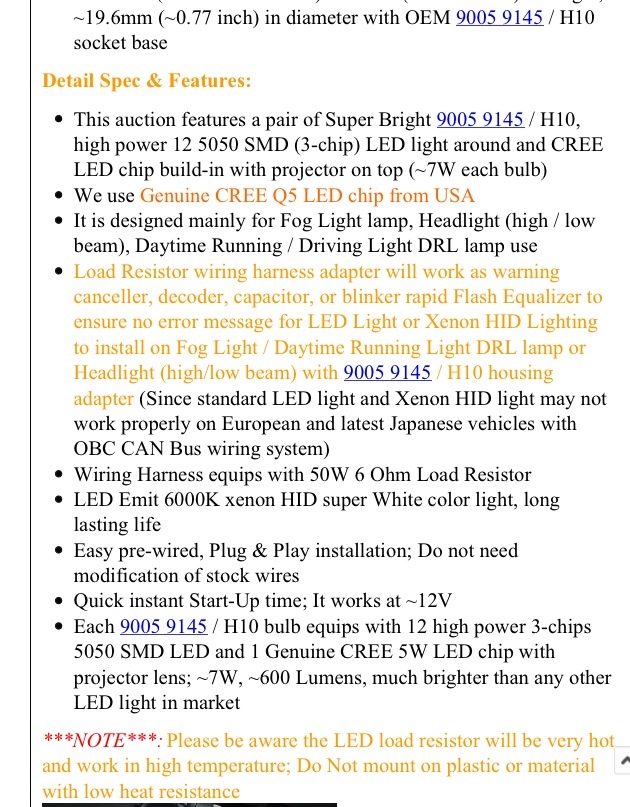

I've been looking for led bulbs to swap out my halogen low beams. Came across these and wondered if anyone has tried them.
They specifically told me that they will work and come with the resistor to eliminate the error code. I need to measure the opening for existing bulb and make sure it would fit as well.
Old May 12, 2013 | 11:36 AM
philhef's Avatar
Posts: 2,916
Likes: 547
From: North Carolina
Forgot the bulb photo.
