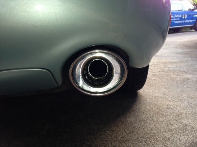

Which 4" oval resonated exhaust tips did you buy and install?
Old Sep 25, 2014 | 09:26 PM
Jandreu's Avatar
Posts: 2,173
Likes: 605
From: Goldsboro, NC
These:
Brand New Polished Stainless Oval Rolled Slant Resonated Exhaust Tip | eBay
The resonated tip made the exhaust note just a tad deeper but most probably would not be able to tell.

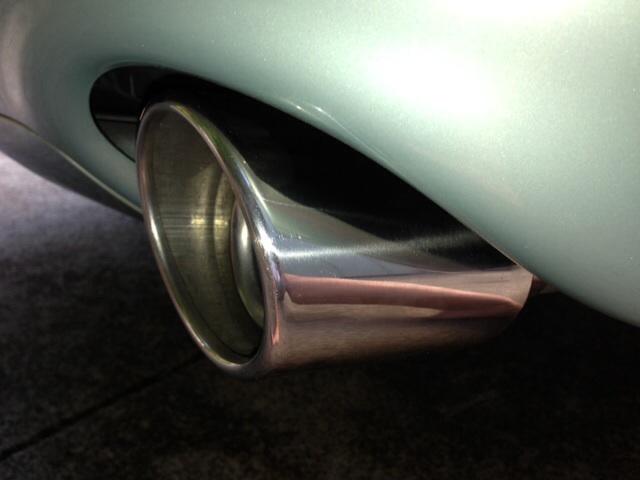

Here"'s another view.
I got the 2.25" and had to buy a sleeve to make them fit, the 2" would probably fit just right. Just used some exhaust sealer paste and pop rivets to secure. Look great and no issues with coming loose. Local shop wanted $50 to weld them on.
