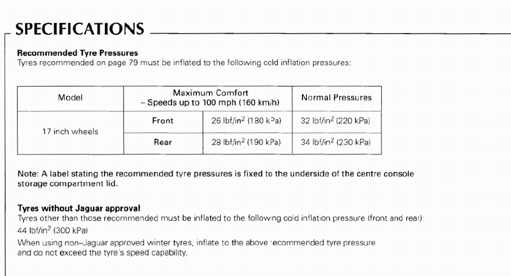

Originally Posted by NTIWOAJ
I have Michelin Pilot something(not SS). They're on 17 inch wheels. The pressure was so high that the suspension and shocks couldn't handle it. I switched pressure to 27 front and 29 rear. .....
Welcome to the forum Gary,
Michelin Pilot Sport perhaps? Michelin are "Jaguar approved" and can be run at the recommended pressures.
The tyres may have been set to the same pressures front and rear by the PO misunderstanding the advice in the Vehicle Care Handbook for the 1997 MY and setting them for "other than recommended":
I expect you will get accelerated tyre wear on the rear by dropping them below 30 psi. 28 Rear/26 Front is sometimes referred to as "comfort setting". It does give a softer ride but at the expense of reduced tyre life.
