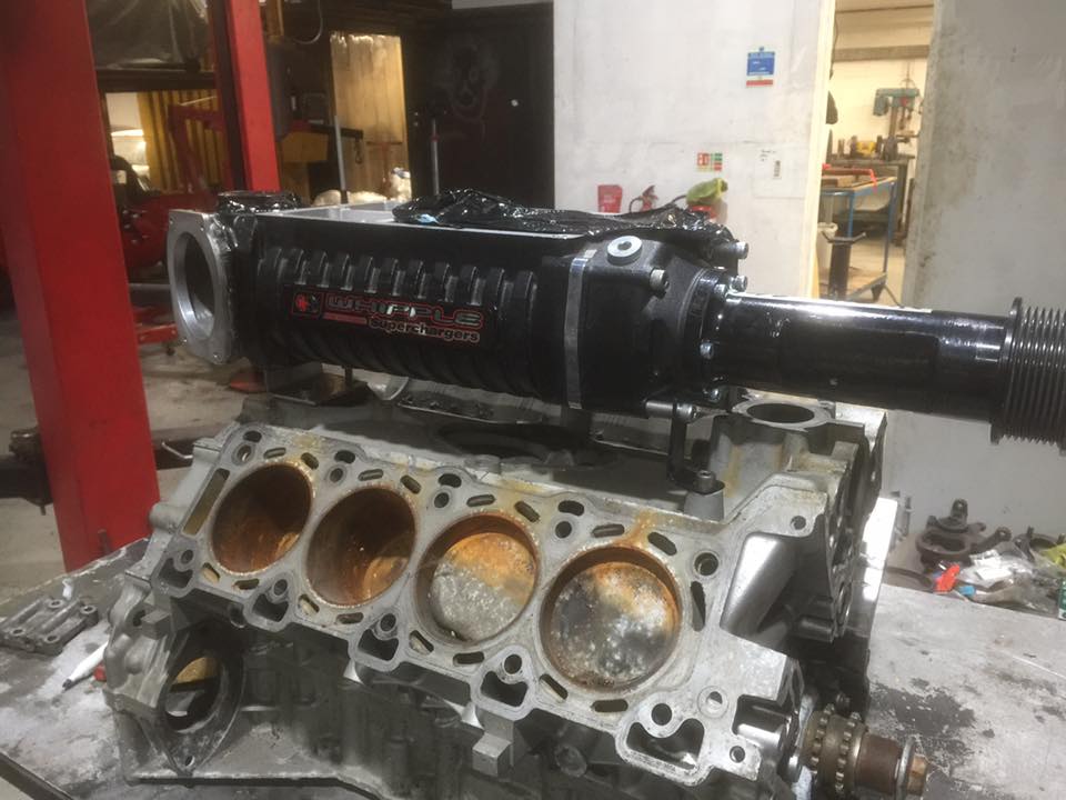

Tom Lenthall ( Home - Tom Lenthall Ltd - Jaguar Land Rover Specialist ) is going to develop a new supercharger kit for our high-performance V8!
He told me he will be ready soon!

Is this likely to clear a stock hood? It doesn't look that tall and is very attractive lol.

let them work and see what happens

my first thought as well. I'll keep an eye on development.

Very cool , looks impressive ! I like how it's cable TB .
That car will be an animal. And what better car to put it in .

That model is a 2.9l, so the biggest supercharger I've seen yet on our engine. That car also has a 4.8 stroked engine and manual box so brilliant indeed!

As far as I am aware, he uses a 4.4 engine from RR (based on the Jag 4.2 engine), which has a wider bore of 88mm and isn't stroked.
Am curious how far he gets, the ingredients are there now so should go well, but as a side note, on street fuel there is still a limit of maximum boost, regardless of how big or small the supercharger is.

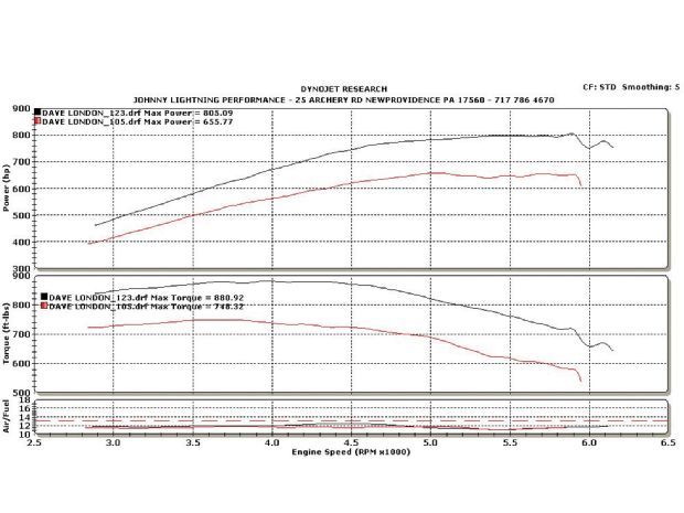

Nice dyno comparison between the 2.6H and 2.8H attached.
Baseline with 2.6H was 655rwhp/748rwtq with 3.5" upper pulley and 12" lower. With no other mods other than 2.8H and bigger injectors, it made 805rwhp and 880rwtq.
For those numbers they actually used the same 3.5" upper but only a 10" lower on the 2.8H as otherwise it would've made too much boost. Peak gains of 150rwhp and 132rwtq even whist spinning slower than the 2.6H. Full article here: Kenne Bell Supercharger Upgrade - Muscle Mustangs & Fast Fords Magazine
I've seen similar gains on 4.6 cobra mustang too. I'd be interested in your 2.6 if you upgrade in the future.
