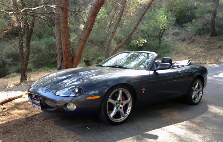

Hi,
I just bought a 2004 XKR convertible. I had it checked out by a mechanic and it got a pretty clean bill of health, though it has a few issues.
The most pressing is the intermittent fault "Check Rear Lights" and "Cruise not Available." from reading here I see that it's most likely the brake pedal switch, which was also what the mechanic thought.
Recall # J026 was not performed, so I will take care of that too. Passenger headrest motor turns but doesn't move the rest. Thanks to JaguarForums, I've seen the TSB about that (though I don't know if I will bother that soon).

This car came from Carmax and has a 30 day warranty. In addition, we bought a 4 year extended warranty ("named exclusion" type). I usually don't believe in those, but I thought given the complexity of the car it might be worthwhile.
My wife and I spent the weekend driving all over with the top down. I haven't owned a convertible since I was a kid (52 now). It felt great!
I'm ging to check out the regional section and see what's going on there. I used to do a little time-trialling and vintage racing. I doubt I'll race this, but a track day would be fun!
Any comments or advice welcome. Thanks again for all the posts I read before purchase, it really gave me a good understanding of these cars.
