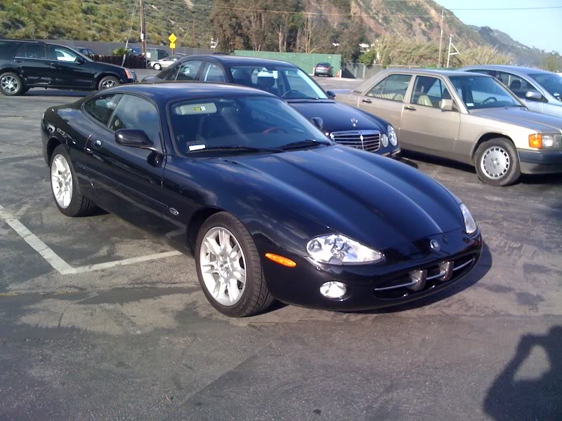

I did it! I am now a proud new owner of an XK8...
Not the greatest photo but I'll post it anyway.
