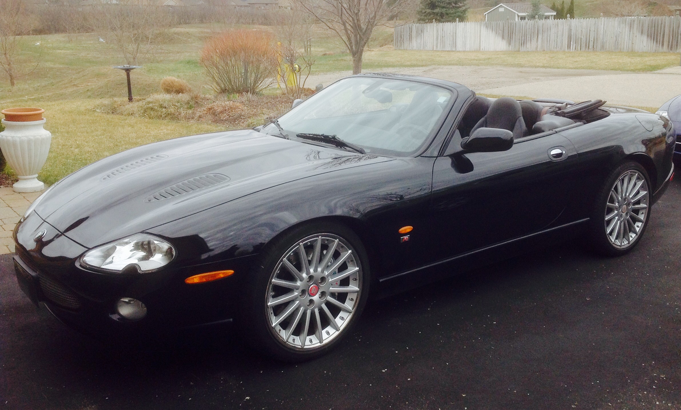

I also purchased a 2005 XKR six months ago, former Florida car. Not able to obtain any history although the vehicle was in great condition (71,000 miles) and drove very well. To establish a base line for routine servicing I had:-
Engine oil changed.
New oil filter.
New air filter.
Transmission fluid changed and new pass through rubber installed.
Changed the supercharger oil.
Had one rear rim (20 inch Persangs) put back to "round".
My car also sits low at the front, 14.25 front, 16.0 rear so a change of upper shock mounts is in the very near future.
Was very pleased to find that the hoses to the front hood latch are dated 2009, so it looks as though I may not have to be concerned about a "green shower"......let us pray!
Also changed the GPS to a Garmin unit so navigation is totally up to date.
Other than that, so far so good. Must say I love the looks, power and comfort of the car, probably the nicest vehicle I have owned. Especially enjoy not seeing myself coming the other way all the time.
Regards to all on this great forum
GBCat
